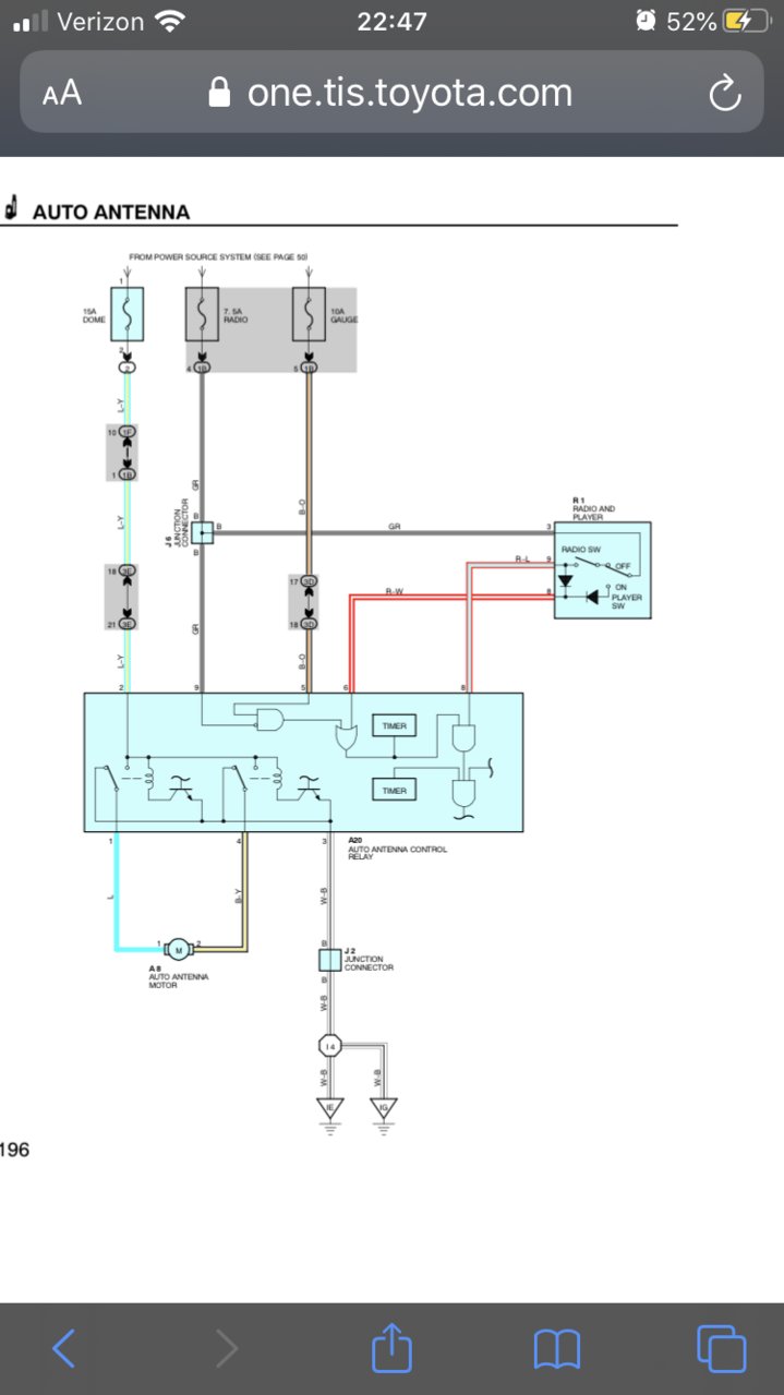

    I’m FINALLY getting around to installing this OEM antenna.
    The 2 OEM wires on the antenna are,
    1) green with a red strip
    2) solid green
    The radio trigger wire is blue I think.
    How do you wire this setup?
    Thanks in advance

    @1997tacomav6 I installed a power antenna on my 2000. You’ll need the power antenna relay too.

    Even if the aftermarket radio has a power antenna trigger power wire?

    this is all i have for you
    welcome to the cool kids club! :hattip:

    I would think so, if you have an aftermarket deck, it gets wired right into the OEM harness with an adapter just like the rest of the connections. I had an OEM stereo so I needed it. There should be an 8 pin connector hanging out in space near the stereo. Here’s the Toyota wiring diagram for the power antenna

    Is there not an easier way to do this rather than trying to deal with 8 pins in a relay box when using
    an aftermarket radio with the power trigger wire
    The OEM antenna HAS to have a relay TO work?

    yes, I got one from a 96 SR5 Tacoma a guy was parting out in Colorado Springs. Once you get the relay, and hook up the trigger wire, the power antenna will work. Additionally I started thinking about it this morning, my wife’s 4Runner has an aftermarket deck with a power antenna, and all the OEM parts are there.
    EDIT- part number for the antenna relay is 85914-04010, it’s discontinued. So you’ll have to find someone parting out a SR5/Limited 95-00
