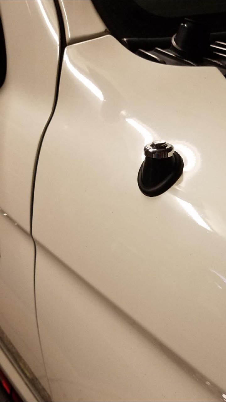

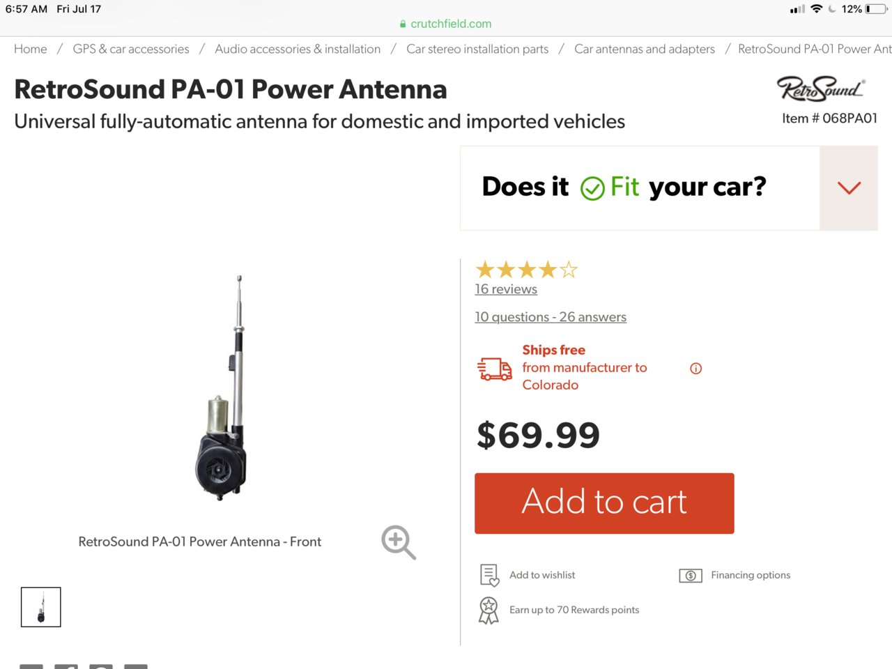

    Well because the OEM antenna needs the OEM relay and that relay has 8 wire pin out I just made it simple and bought a universal power antenna,
    3 wire setup ground, power, radio trigger.
    Had to use the OEM antenna fender plastic cap with some trimming to get the universal antenna to fit correctly in the fender hole and look OEM.
    Cost 65.00
    GQ7227 likes this.

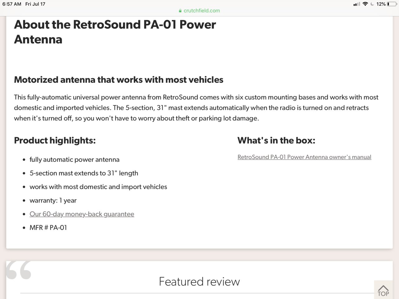

    Yes, it’s 31”,
    It goes up and down if the radio is on when the key ignition is turned on or off,
    and goes up and down if you turn the radio off from the radio power source
    GQ7227[QUOTED] likes this.

    Because it’s a universal antenna it took a little extra time to make it fit.
    The bracket that attaches to the body and the fender plastic sleeve needs to be customized,
    Use the OEM Toyota fender sleeve tho, the aftermarket ones don’t fit correctly,
    I had to drill out the sleeve a bit larger and cut the bottom off just a bit to make it work

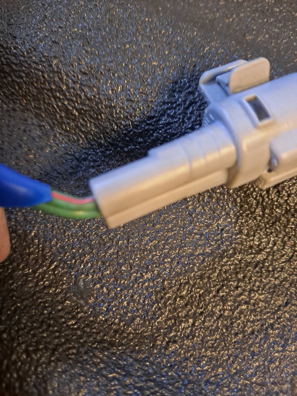

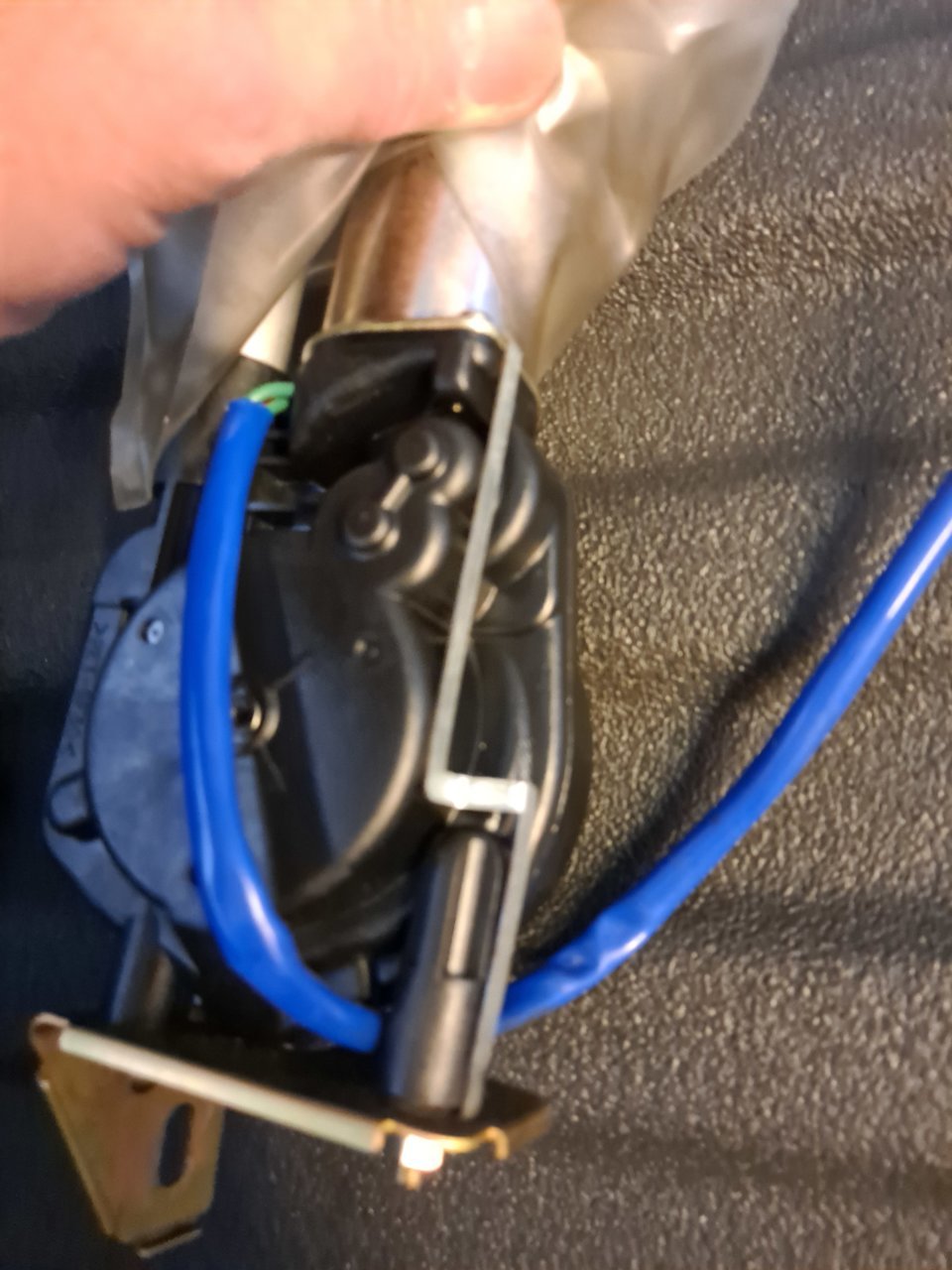

    Ok so the aftermarket one has failed 2 times,
    The motor just stops so I'm trying a 3rd time under warranty.
    So time to revisit the OEM antenna.
    I ran a ground wire to the negative side and to the ground strap on the antenna that goes to the metal
    motor case.
    I connected a positive wire to both of the green wires coming out if the wire connector,
    Nothing
    I was afraid to connect the positive and negative wire in the wire connector incase it shorts,
    Do you know if the connector wires in the 2 wire green harness are positive or negative?
    I want to see if this antenna had a limit switch inside
  12. Oct 5, 2020 at 6:19 PM
    #32
    00_5VZ
    00_5VZ Dumbest smart guy you’ll ever meet
    Jun 24, 2017
    #222322
    237
    Rob
    Thornton, CO
    2004 DC TRD, S/C, Impulse Red Pearl
    TRD S/C, URD 7th injector, Deck plate mod, gray wire mod, 2 low mod, magnaflow cat back exhaust
    The OEM power antenna doesn’t have a limit switch, the limit switch is part of the antenna relay. I don’t know if the antenna relay is still available from Toyota.
    1997tacomav6[QUOTED] likes this.

    For now I'll just say that the OEM antenna is NOT an automatic antenna. It is a Semi-automatic. Meaning that it has NO inner limits. The limit are controlled by timers in the OEM relay Module and that's what made it fully auto. You can use regular Bosch style 5 pi relays but you will have to use a switch to control the antenna "manually".
    What exactly was the fault with the antennas. What do you mean the "motor just stops". Just stops working? Stops when going down? Does not go down at all? Does not go up?
