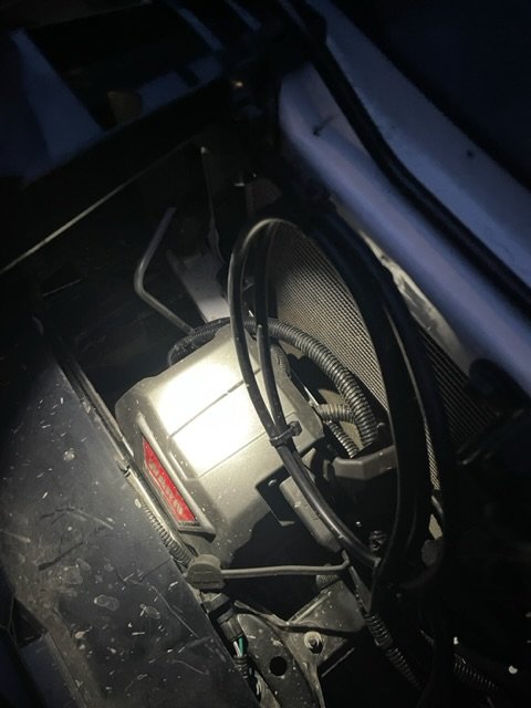

    I was in your boat about 6 months ago, new to bumpers and winches. There’s a post on TW by @ClassyTacos relocating his winch solenoid.
    I followed his lead- same hardware (readily available locally) for the solenoid mount.
    You didn’t mention winch brand, but I went with a Warn 10S and their Bluetooth remote option. At the time and maybe still (haven’t checked), they don’t have a true wireless remote any other way. Happy with the BT option.
    Crappy pic, happy to help if you have any questions.
