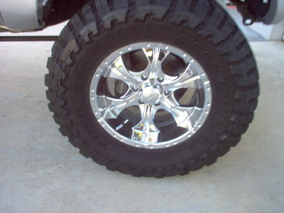

    good choice thats what i have... on my radiant red :)
    17's 285/70R17 duratracs

    Tire and rim combo looks good. Agressive looking tread design on tire. They should pull good through just about any terrain.
