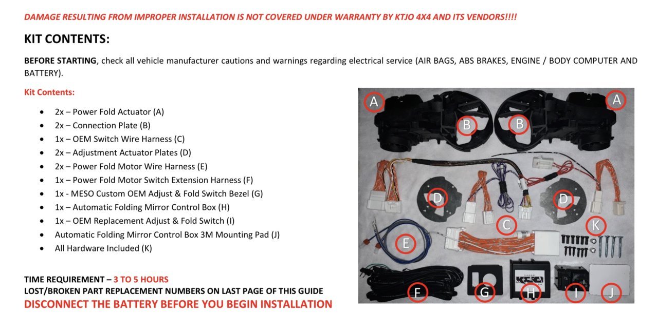

    I aligned the locator pin thing. No up/down play at all. It was easy to locate the holes. They were actually a little too close to the center of the hinge. The Allen head cap screws supplied rubbed against the center part of the hinge. I would like to know where the motors and mirror adjust/fold switch are sourced in case I need replacements. I can supply pictures of the connector with the 360 cam wiring. I think earlier versions of this parts kit used different (separate) fold switches. I saw options for unlit, 'lower lit', and fully lit switches.

    I didn't reuse the spring or plate. Their install guide is better, but still has a lot of holes. If they would provide customer support, they would get feedback that would help them make a better product.

    Check KTJO.com for their latest install guide. I think the Allen head screws are just M6 cap screws, Maybe 10-15 MM long.

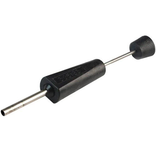

    Check peachloft.com for pin removal tool.

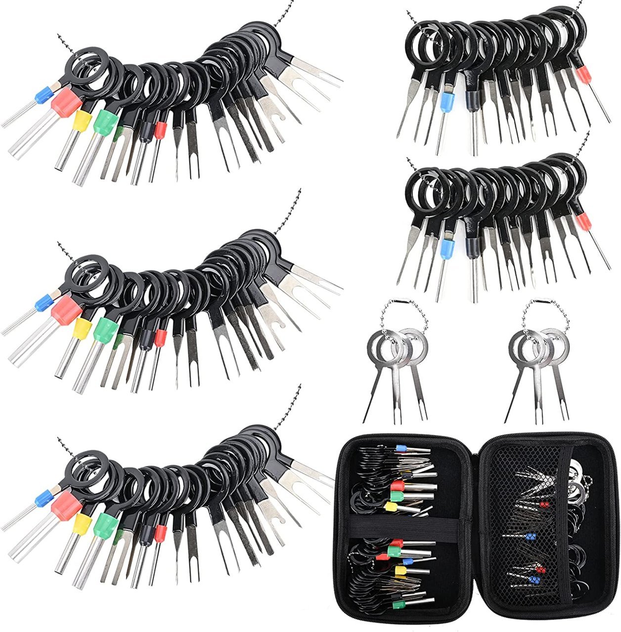

    8195xgzASmS._AC_SL1500_.jpg C-AMP37RT-2_c28b6ecf-7b1c-4afd-8855-06efa883224a_500x500.jpg

    I’m pretty sure none of the parts in this kit are specific to KTJO. I’ll have to dig up my instructions again and see. I could have sworn the motors were from another model Toyota.
    Personally I wouldn’t buy anything from that company unless it’s money you don’t want. I think they got banned from this site as well because of their poor service.
    Scratch that. There is a lot of wiring that will probably be a pain in the ass to do without the kit.

    None of the very low-quality pin extractors shown will work, believe me I've gotten a set and have been able to use only a few on some very old fashion connectors. If you would like to see the type/family of connectors the mirrors use just look at the left rear two connectors in your under-hood fuse box. Those U-shaped holes are the access to the pin release tabs.

    The 3-5 hour installation time estimate is a joke. It will take at least all day. Mine works well so far (Except for the backwards operation. Easy fix, but why do I have to?). KTJO has some good ideas, but fails epically on execution and customer service. The wires to the fuse holder should be long enough to allow it to be left just inside the window switch panel.
