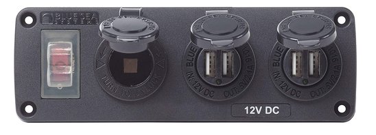

    That's the one we have. It runs our cooler for a few days... we also use it to run a fan in the summer and some LED light strips in the truck bed. When it was unexpectedly cold we camped with a heated throw blanket and it ran it overnight. When we are on road trips I recharge the Ecoflow from the 12-volt outlet I put in the bed. If the battery ever wears out, I will replace it with one of the new ones with the better battery chemistry but I expect to get several more years of life out of it. I got it from Costco last year when they had it on sale for $429.

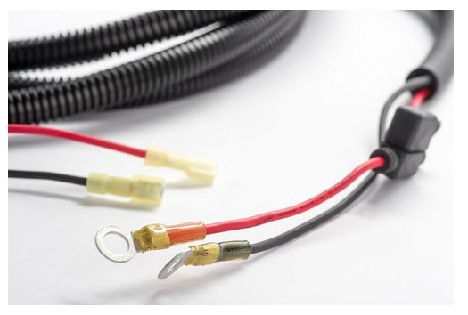

    I have an SR and used this kit for the power outlet - it came with a loomed/fused harness, super easy.
    https://www.genesisoffroad.com/12v-accessory-panel-3.html
