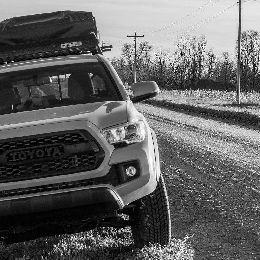

    yes. Not enough power.
    What am I trying to do with it you ask? Oh, just drive.
    I live at 9,600ft in Colorado. I have a lot against me with just that going on, don’t mention the rack and tent adding a 500lbs, or the front bumper that is 150lb, or the soon to be added rear bumper of 60-100lbs.
    Is there anyway to squeak out 25-100 more HP or torque?
    I plan on doing a lot of higher elevation drives, and really notice the truck struggling more with the added weight.
    Turbo? Turbos Plural? Supercharger? Hi-flow exhaust? Is there anything I can do under 5,000$?6802F1DF-2573-45FF-9F8B-C76E0BC13330.jpg5C4CE0B2-1B95-4350-B832-874C73073C84.jpg

    might be that the roof mounted rack/tent/weight could be hurting the aerodynamics of the truck, resulting in a loss of power/performance. the rack could be catching a lot of wind resistance, maybe somehow mounting the rack in the bed behind the cab would be a better alternative than to mechanically trying to get more power from the truck

    It’s a truck, it’s not meant to be airodynamic.
    I’m not looking for speed, without the tent- rack, etc: i used to be able to drive over the continental divide (11,300ft) in 5th, now it’s 4th required.
