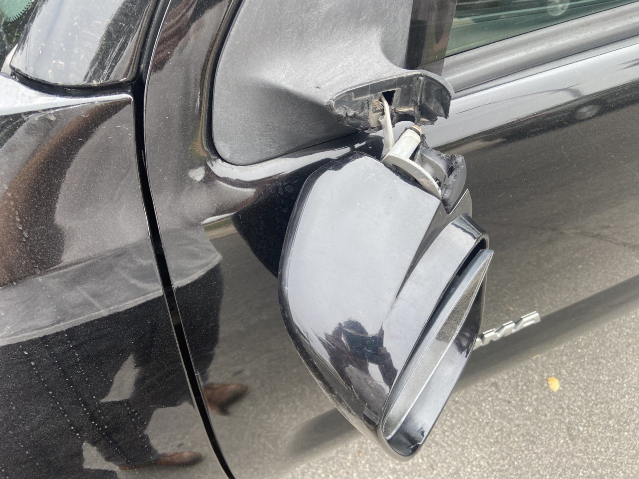

    Someone clipped my truck this morning destroying the plastic attachment from door to mirror. Does anyone know any fixes for this? Places to get a decent mirror replacement?

    A temp fix is JB plastic weld if the pieces still match up, or marine epoxy putty if you have to fill gaps. Use masking tape as a clamp while it dries. You won't be able to fold it, but it will work until you get a replacement. Putting the new one on takes 5 minutes and 3 bolts.
    I use https://parts.olathetoyota.com/ for OEM parts.
