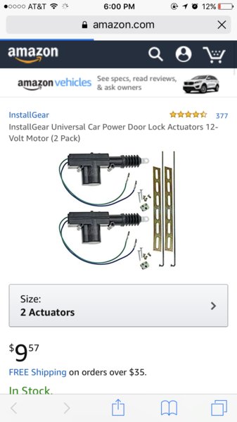

    Yeah I think Ima get everything aftermarket. I'm gonna order these pop up locks right here

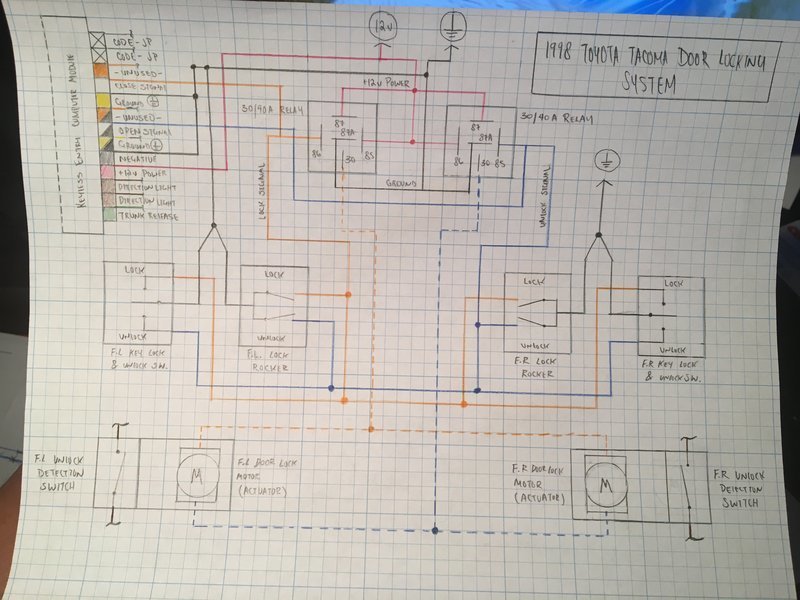

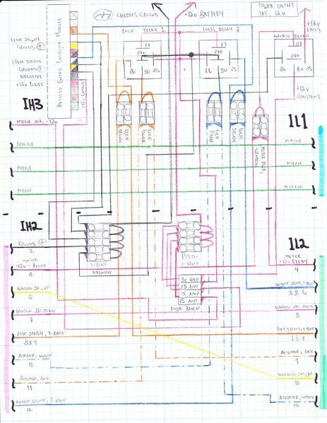

  19. Apr 18, 2017 at 11:54 PM
    #19
    BartMaster1234
    Aug 21, 2016
    #195197
    45,880
    Tyler
    Pittsburgh, Pennsylvania
    Flux Capacitor
    It's not that bad. I have the schematic laid out so it's as simple as creating the wiring harnesses.
    * I wrote 1998 on the door lock system, but is uses 2004 components. I have a '98.
    * A dot along the wiring schematic indicates a splice or junction point.
    * For more details check out my build thread linked in my signature.
