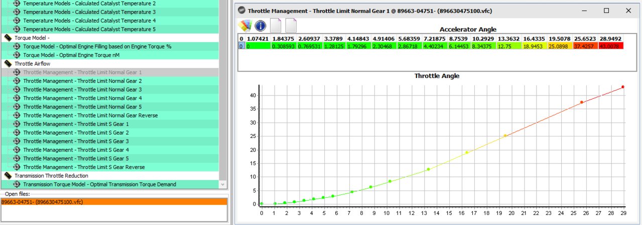

    Okay, but what are your 1st Gear torque limits? From the current set of maps that we have access to, I don't see any:
    That's from ECU ID 04751, which is the TSB tune for the 2011 V6 4WD MT.
    Compared to the info that I posted in Post 6, the 3rd Gen is being kneecapped:
    https://www.tacomaworld.com/threads/power-loss-on-hill-in-4h-manual-trans.734611/#post-26158897
    I can tell you in my experience with climbs are similar to what you are describing. I can crawl ahead with similar results.
    If @vroomvroom_19 is nearby, I'd edit his Stock tune just as a fun little experiment.

  12. Aug 27, 2021 at 3:08 PM
