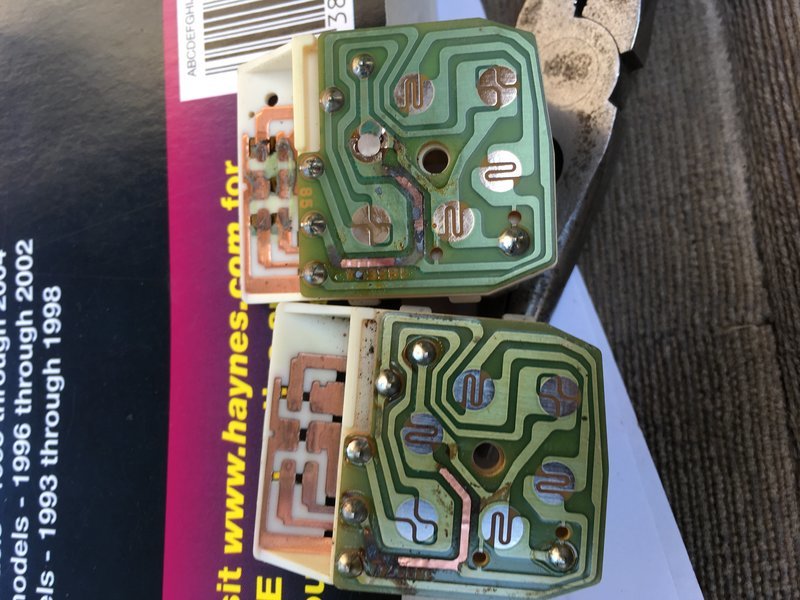

    IMG_8461.jpg So I figured out that there is a short somewhere. The circuit board in the switch is fried. Seems to be happening with the up function. Not sure where the short is though. Trying to find it now. Does that explain power to the right mirror when the selector is in neutral?

    Pull the little triangle piece of plastic off of inside of door to access mirror nuts. Unbolt each mirror and check for a pinched wire were the mirror mounts to the door.

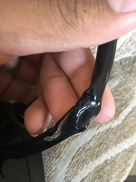

    That's exactly what I just found. You sir are fantastic. Thank you! I should be safe with just replacing the wires, right? With the proper connectors and not just electrical tape.

    Yup ran into that issue when I put power doors into my truck. I didn't use the factory harness hold downs on the passenger mirror, I tightened the mirror too much, and the red wire shorted to the door frame. It burned out my switch like yours.
    I don't think you have to replace the wires unless they're cut in half or the wire stands are damaged. My damage was minimal, all I did was tape the affected wires, re-attached the cable to the door, and replaced the switch.

    I found a new switch on eBay. Should be here Monday. The wires were basically pinched and molded together. So I'm going to cut out the bad section and use some connectors to put them back together. Thanks for the info.
