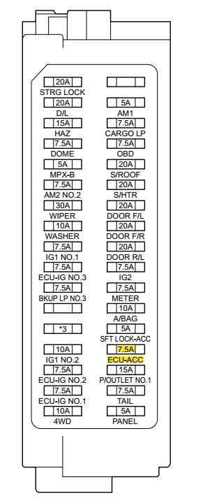

    It's the 7.5A ECU-ACC fuse located under the dash. The name's not intuitive as it does many other things

    The EWD is inverted from the real panel.

    I gotta remember to do a hand stand and use a mirror when looking at the manual. :rolleyes:

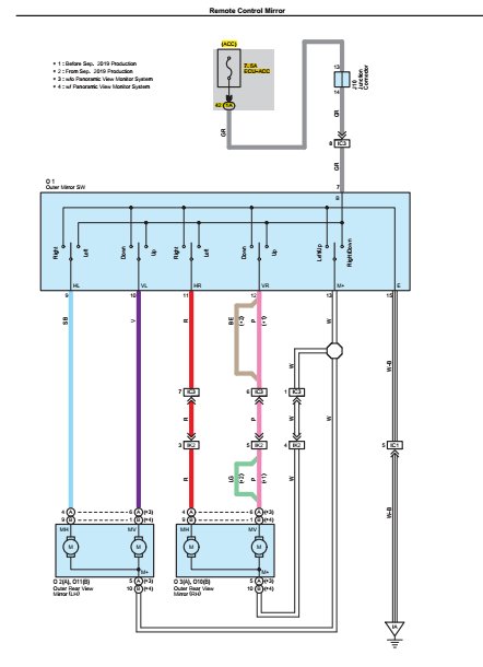

    Yeah, I find this interior fuse box to be maddening; position, cover attachment (which I have broken just getting the thing off). I liked your above post the best of all responses as it gave a clear indication of what I asked for and you included a schematic of what I now need to find the problem. Thanks very much.

    KTJO folding mirrors, I tried to adjust one side, fuse popped, took out headunit as well. I'm never adjusting my mirrors again. :eek: Thanks for this post :thumbsup: Fixed!
