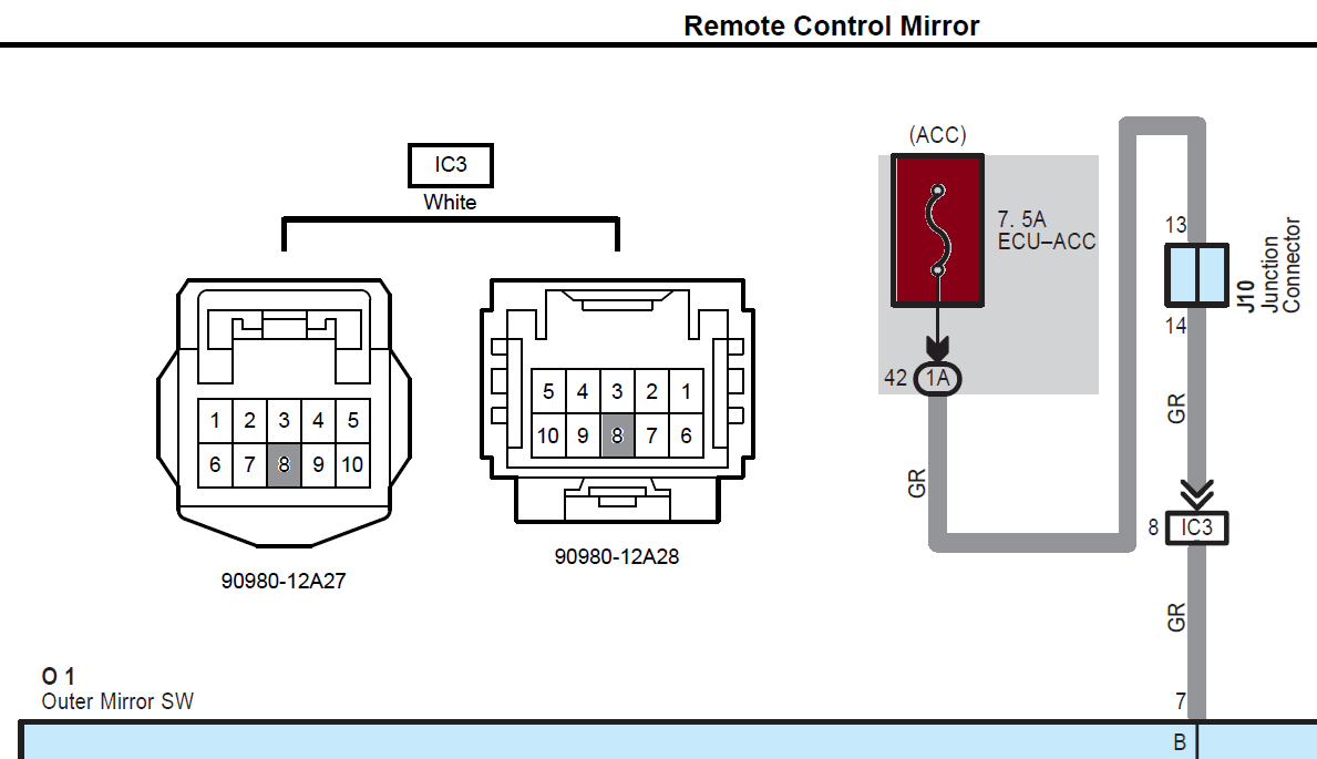

    replace the fuse, just to test.
    Also, continuity from mirror switch connector to IC3_8.
    And with fused removed continuity from IC3_8 to 1A (fuse slot, circuit side)

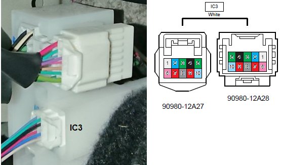

    Driver's side, behind kick panel.

    Yes I replaced the fuse
    And tested continuity
    There is no power in the ic3_8
    my question is does they ic3_8. Come straight from the fuse box or does it go into a junction first

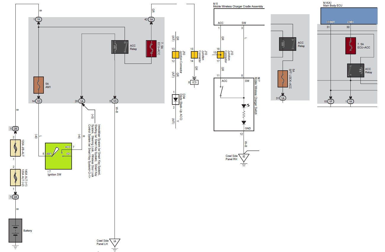

    the ignition is on no power to the junction box. and I don’t know what feeds that or don’t have the diagram for that circuit can’t find a diagram for the mirrors

    Verify that there's power to the dash 12v DC power outlet. (Engine ON)
    That circuit shares same fuse for ACC relay. Also the wireless charger (if the Taco has it).
