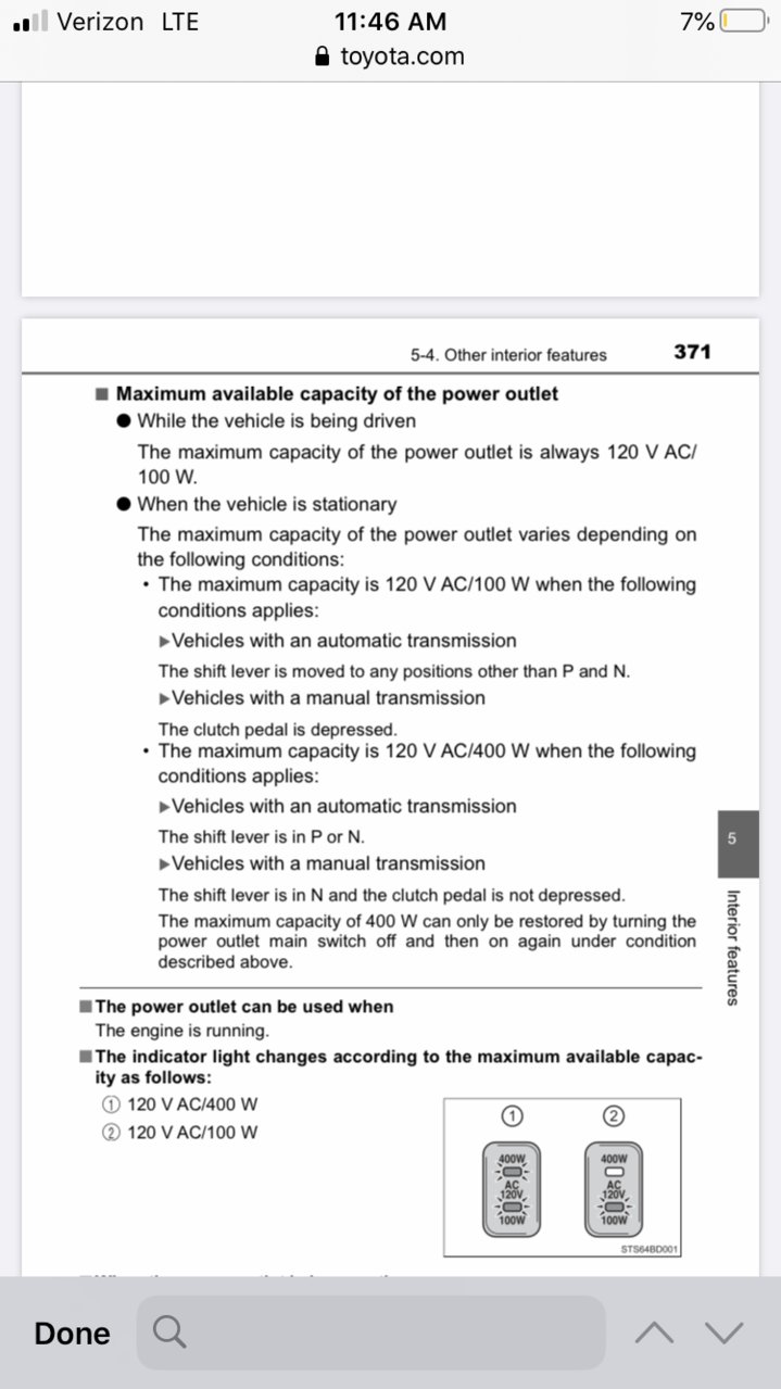

    The problem is that your iron is too high of wattage. 400 watt max on the bed outlet, your iron (according to google) ranges from 800-2000 depending on what model you have.
    When you max out the wattage you trip the "breaker" and it turns off.

    Look dude, it even says on the button that you press to turn it on, 100W engine off, 400W with it on. It's meant for charging power tool batteries, not running irons.

    Not being a dick, but did you read the owners manual? Manual says it can be used without the engine on. It also says 400 watt max (button lights up with either 100 or 400 modes), but im guessing he saw a plug and didnt even think his iron actually draws 800+ watts to run.
    ■The power outlets can be used when
     Vehicles without a smart key system The engine switch is in the “ACC” or “ON” position.
     Vehicles with a smart key system The engine switch is in ACCESSORY or IGNITION ON mode.
    Page 413
    https://www.toyota.com/t3Portal/document/om-s/OM04013U/pdf/OM04013U.pdf
    MasonSTL, pinochle and nomnomtaco like this.

    The portion of the manual you quoted above is regarding the 12V power outlets in the cab.
    To use the bed outlet the engine must be running.
    Edit: I was wrong, the engine doesn't have to be running to use the outlet. At least on my 2015.

    True, it was right above the 120v part, didnt notice it was for 12v. But, ive used my outlet with the engine off, the manual says "the power outlet can be used when - the engine is running" doesnt say must be or only when the engine is running.
    Here is a video of someone doing it without having the engine running.
