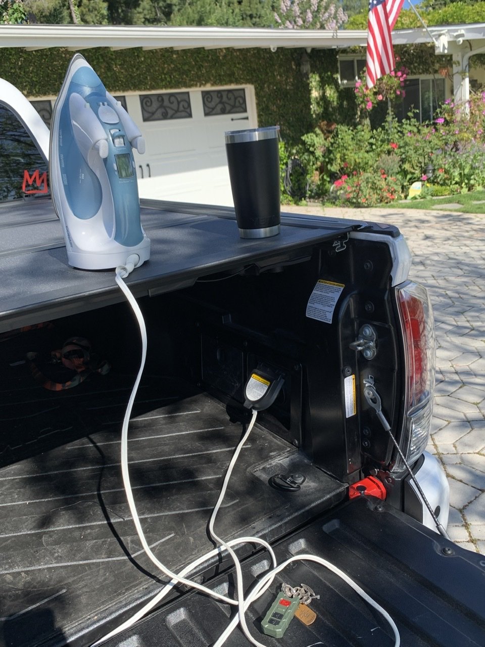

    I don’t have much to do these days. I’m gonna check it with my iron right now. Lol and with a timer set. Screw it.

    Here’s what I found:
    Accessory on, button pushed for power to outlet. Turned iron on in lowest setting, tripped the breaker in 3 seconds. Started the engine, outlet on, iron on for 10 seconds before shutting off.

    The iron way exceeds the rated wattage on the outlet.

    Yes, most irons are 800w or higher. Do your wax at home dude.
