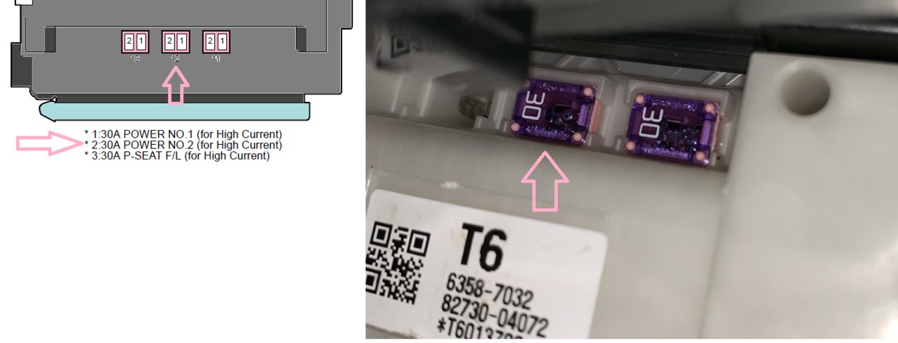

    Long-time lurker, first time posting! I'm trying to figure out how to deactivate my rear power window on my '19 OR... don't read too far into it; it's for a prank. But I read somewhere that theres a harness solely responsible for that window, wondering If anybody knows its location, or which fuse it's tied to and what else that would impact. I've pulled the diagrams and checked my panel covers and theres nothing that mentions the rear power window. Any help is appreciated!

    It's the high capacity fuse. Pink 30A in center slot. It's on the side above the cab fuses.

    Thanks for the tip. I found it, but ended up just removing the head unit and reaching back there.
