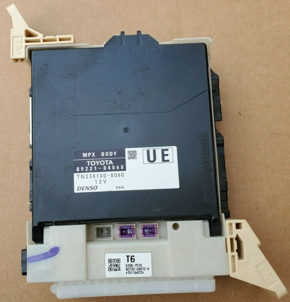

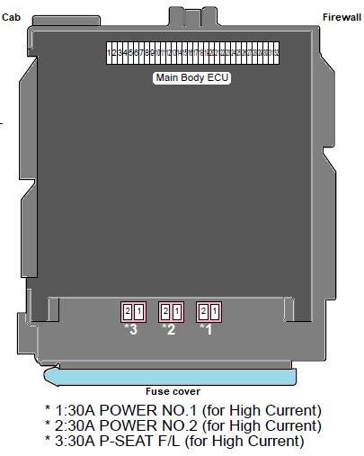

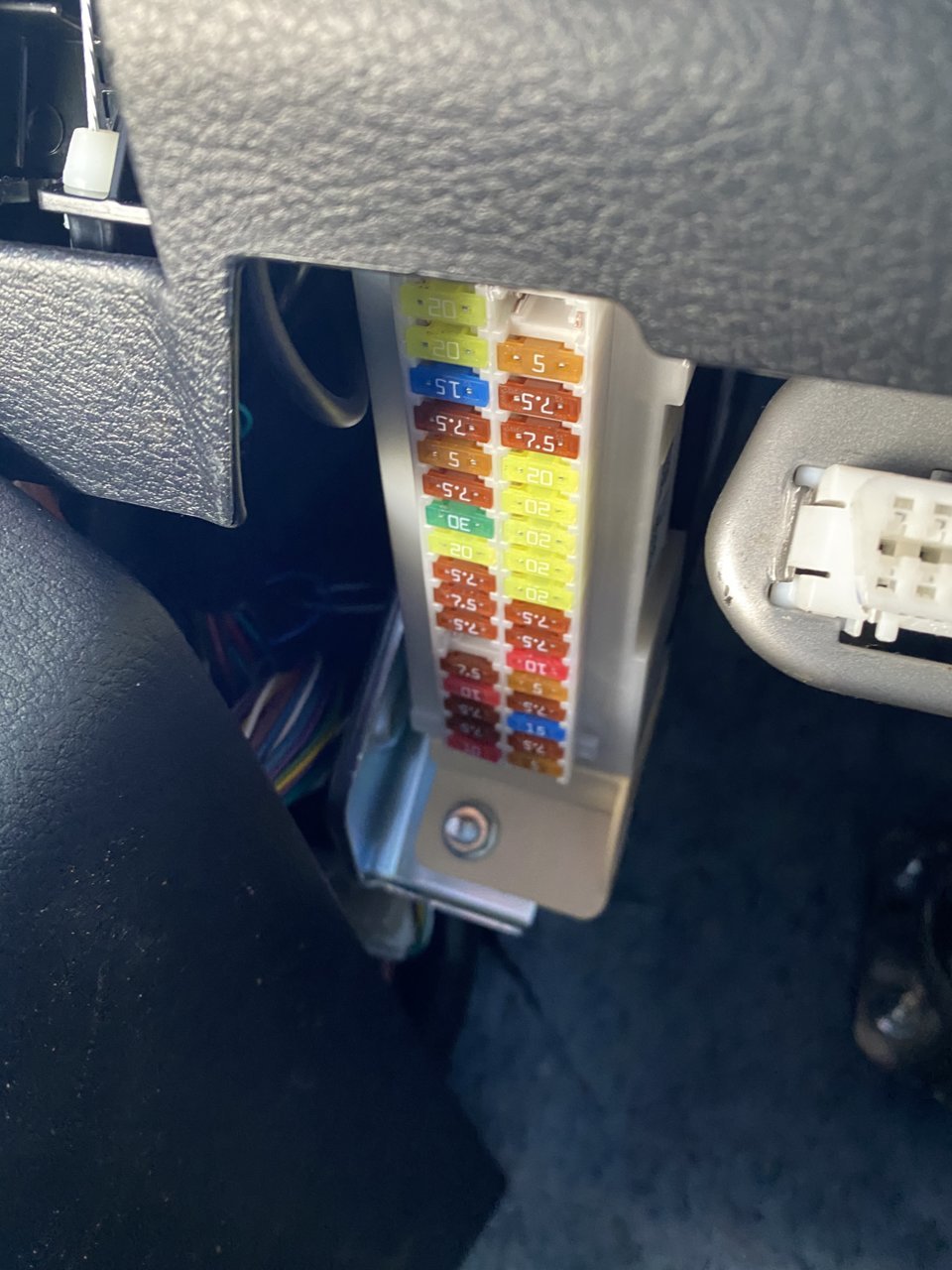

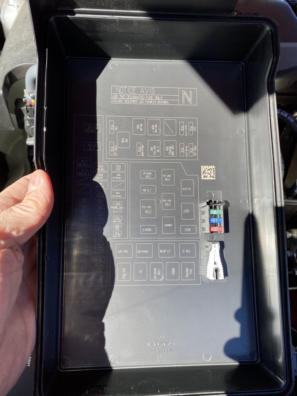

    4E420907-BDCC-4143-B91D-263C4945D3E1.jpg 944D7C38-8425-4002-8D7D-0EC86763193E.jpg I’ve spent about 45 minutes now between yesterday and today trying to figure out what fuse operates my power seat. I’ve done Google search and forum search and cannot find anything that remotely looks like the power seat fuse location. The owners manual doesn’t even list it. I’ve gone so far as to pull most of the fuses and check them and everything looks fine.
    I know, I know I could bring it to the dealer under warranty but I don’t wanna sit there for two or three hours just to swap a fuse unless I don’t have any choice.

    What made the fuse do its job?

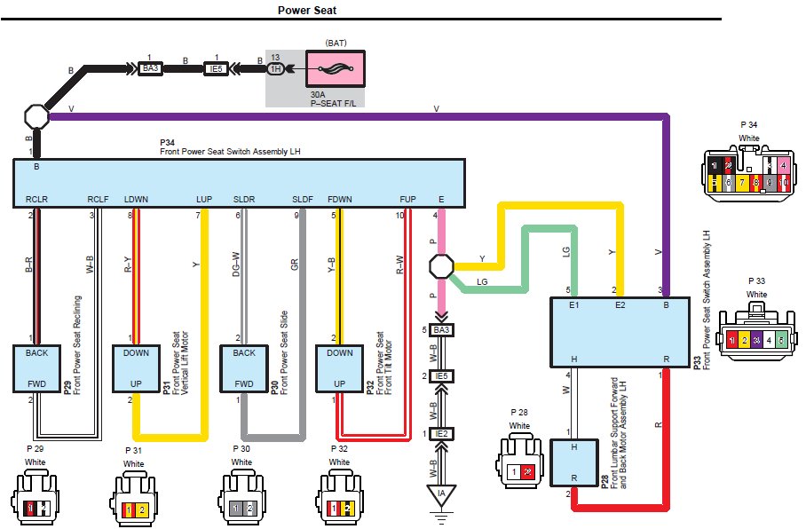

    From the cab fuse box is just one wire to the seat. From there to the switches to the various motors.

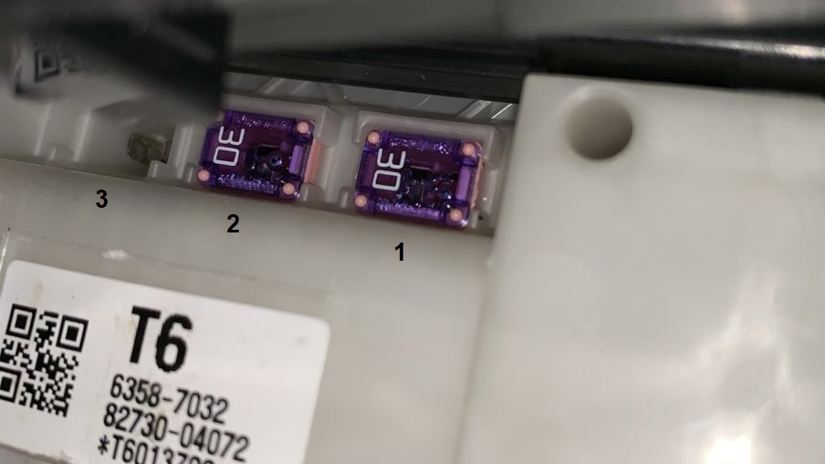

    @caribe makaira or anyone else on this thread: do you know how to remove the module pictured above, so I can gain access to the fuse? I have removed the 10mm bolt, thinking that would allow the module to drop down enough to get at the power seat fuse… but even with the bolt off, it won’t release.

    It has one on top, another on bottom. Plus all the connectors...and the relay junction on the side.
