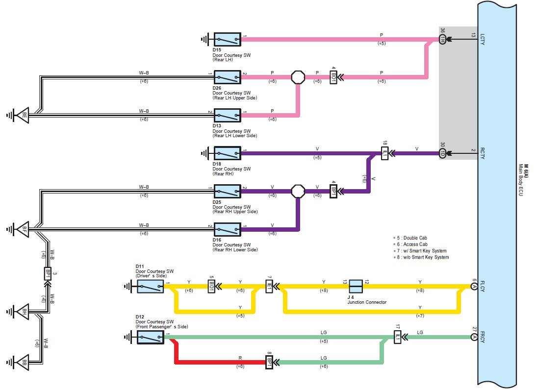

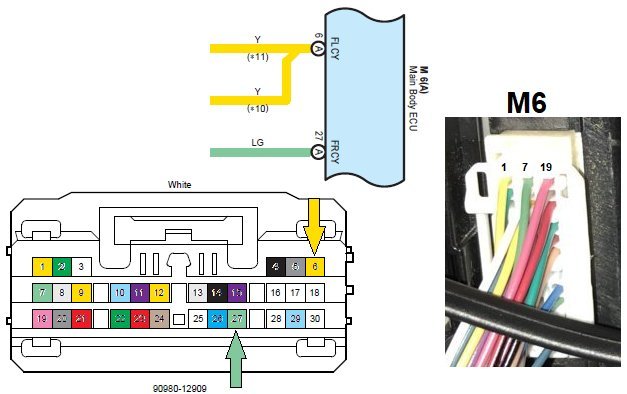

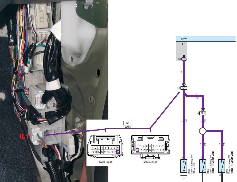

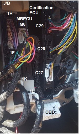

    I got you bro! So I did this a few months back and I have to give credit to @caribe makaira as he was the one that gave me these. I will say when installing mine they had tabs on the top of the motor that you were supposed to hang on the frame and the one bolt goes through the hold you made. Well on my 2021 TRD/OR the front bracket area they were telling me to put template and mount was impossible. the frame had more welding on it and enclosed so the top tab couldn't physically hang on the top of the frame. Ultimately I slid the bracket down to an already hold in the frame and it wasn't too far away. Of course this means the bracket isn't under the main stepping area when getting in on driver side, however this really didn't lead to improper weight coverage as I am 150 and I am the only one driving so I just don't jump on the step. That said these diagrams Were a huge help and Caribe is absolutely right when he told me to use these wires instead of splicing from the loom on the ground. I tried a few splicing but I wasn't getting the correct wire as colors overlap a little in the loom however you cannot go wrong if you follow this diagram and I had it wired up in 15 minutes so best of luck!
    Here is my original thread as well
    https://www.tacomaworld.com/threads/2021-tacoma-door-wiring-for-amp-power-steps.778041/

    Sorry I couldn't get this to you earlier. it's possible they changed the wringing but I would think the termination points in the plug might still be the same so if you trace the positions you need from my pictures you should be able to do it.
    That said great job on getting Toyota to do it for you!
