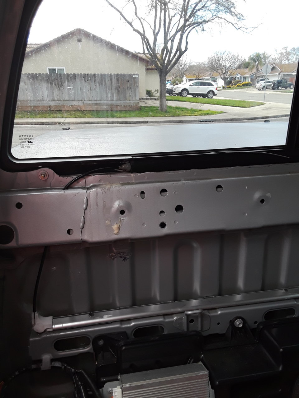

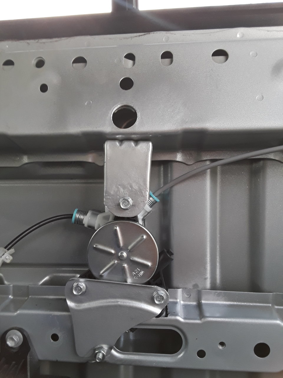

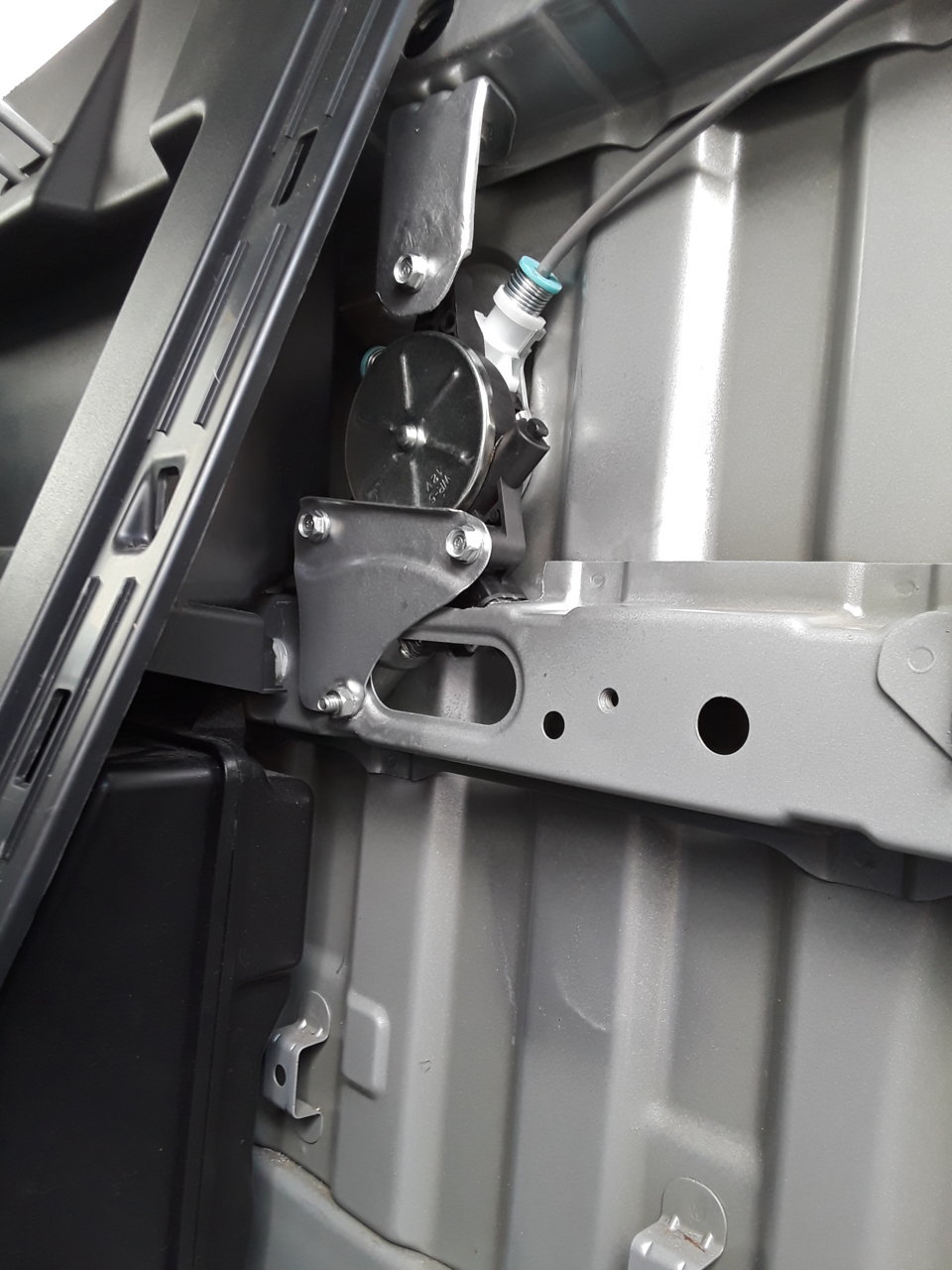

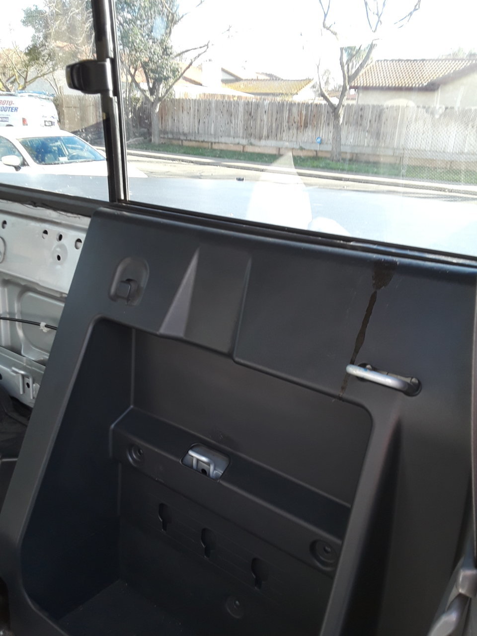

    Grille, floor mats, navi, heated seats, bed cover, fj wheels, custom door cloth.

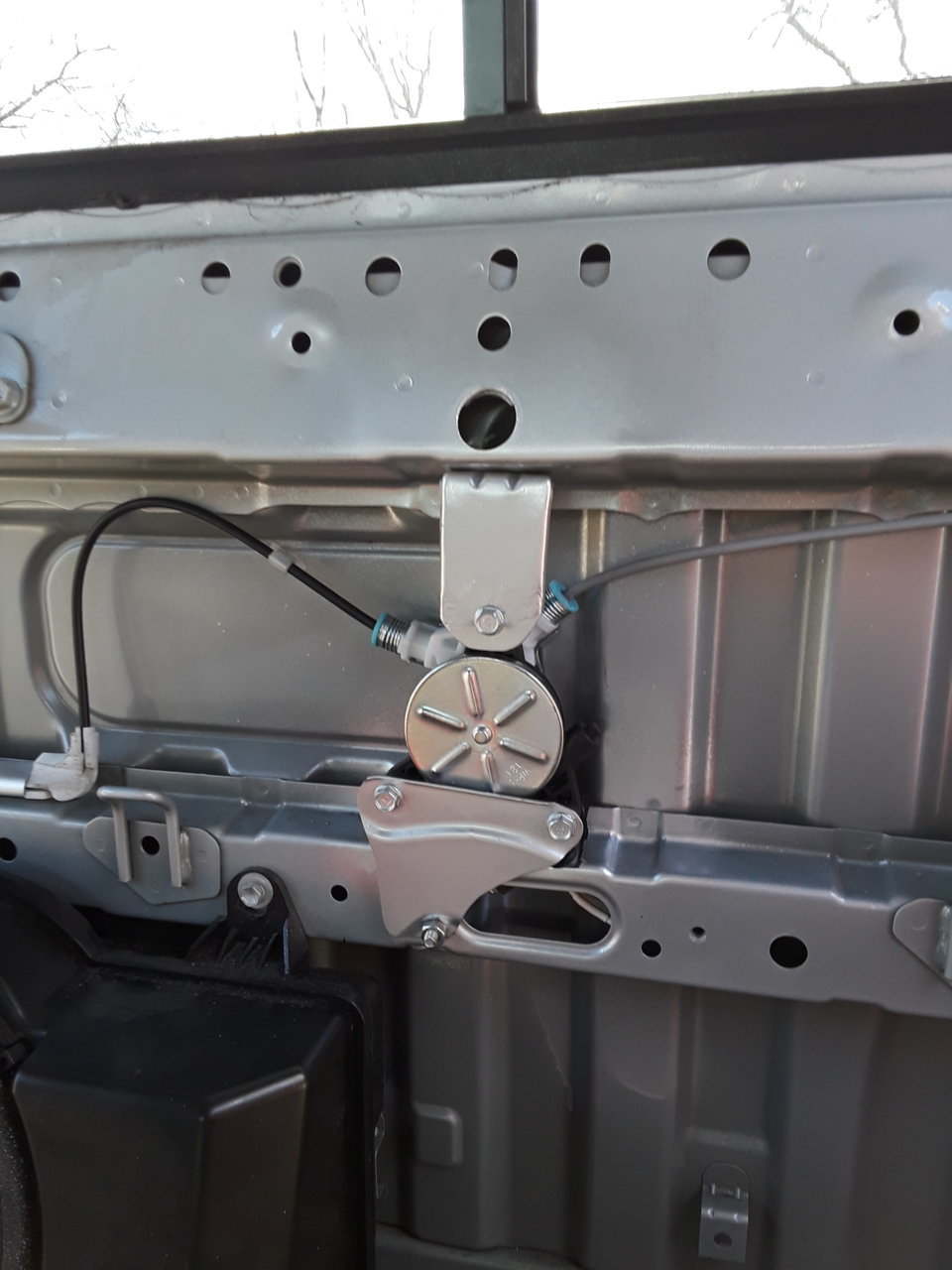

    ACEkraut and Hit n Run like this.

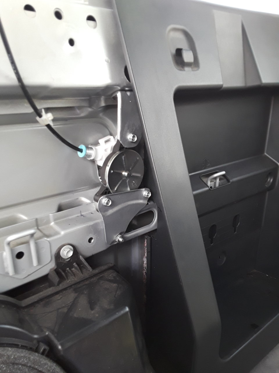

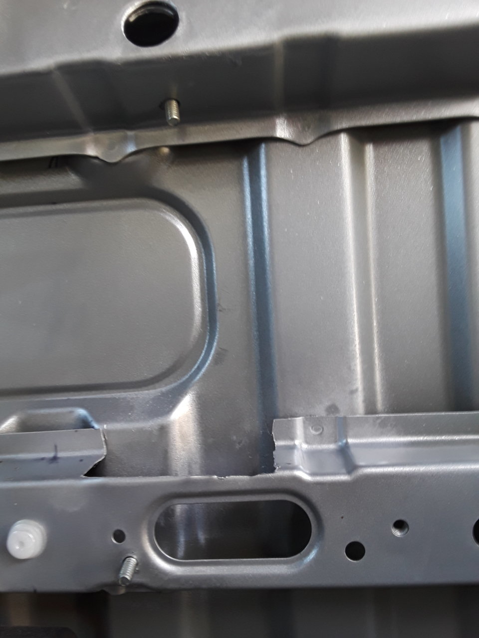

    Pass side mostly done, gotta extend the cable to the window bracket 20190216_153648.jpg
    ACEkraut likes this.

    Stockish 06 sport prerunner

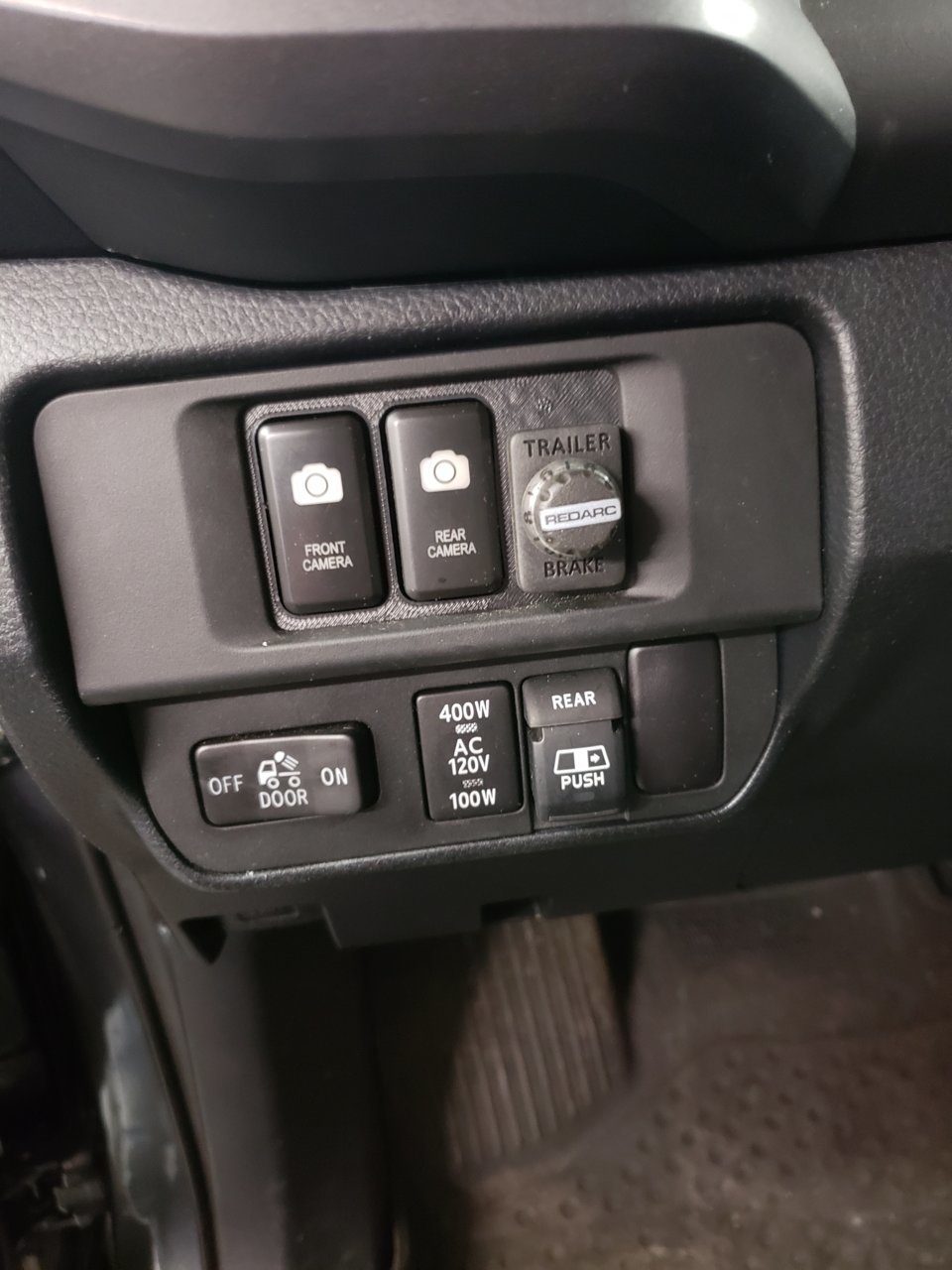

    All done, finally took the clips off the blue springs and it barely even moved, now on to the switch...20190217_113431.jpg 20190217_113431.jpg
    bobsuruncle likes this.

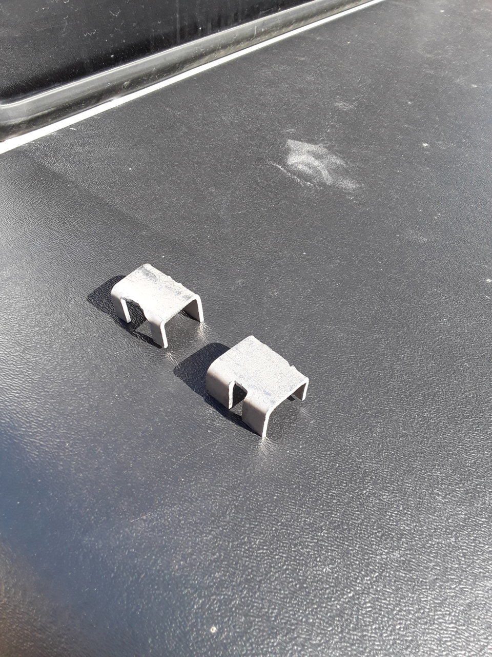

    Works like a champ, here are the clamps I used for the springs, if anybody is in need of these, I'll send them to u for free, good luck20190217_115525.jpg
