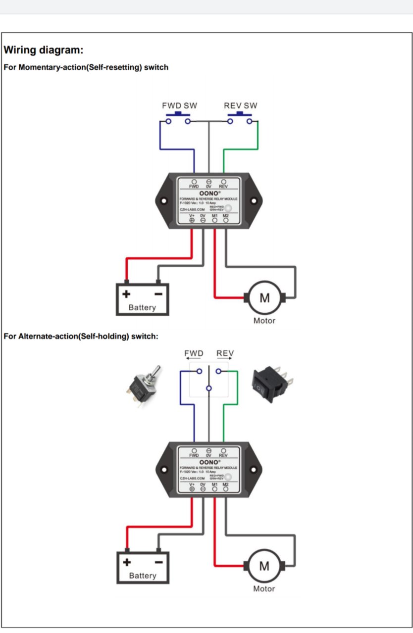

    10 Amp 12v reversing relay

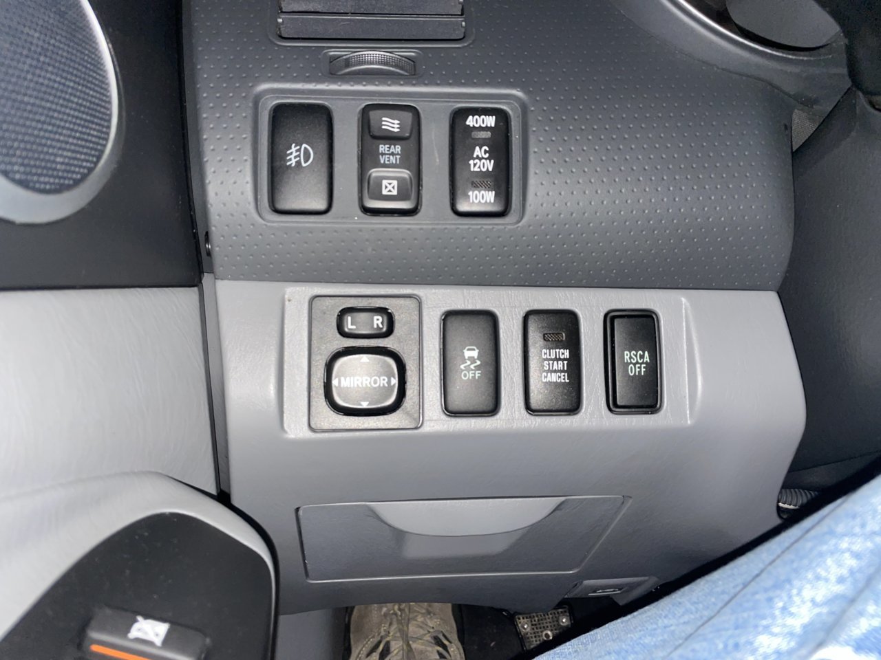

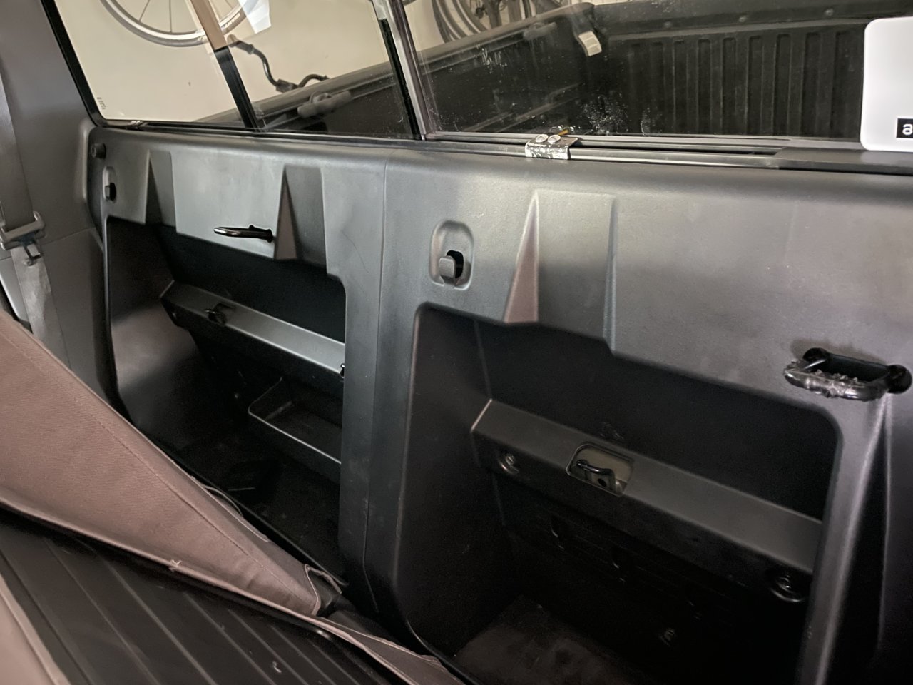

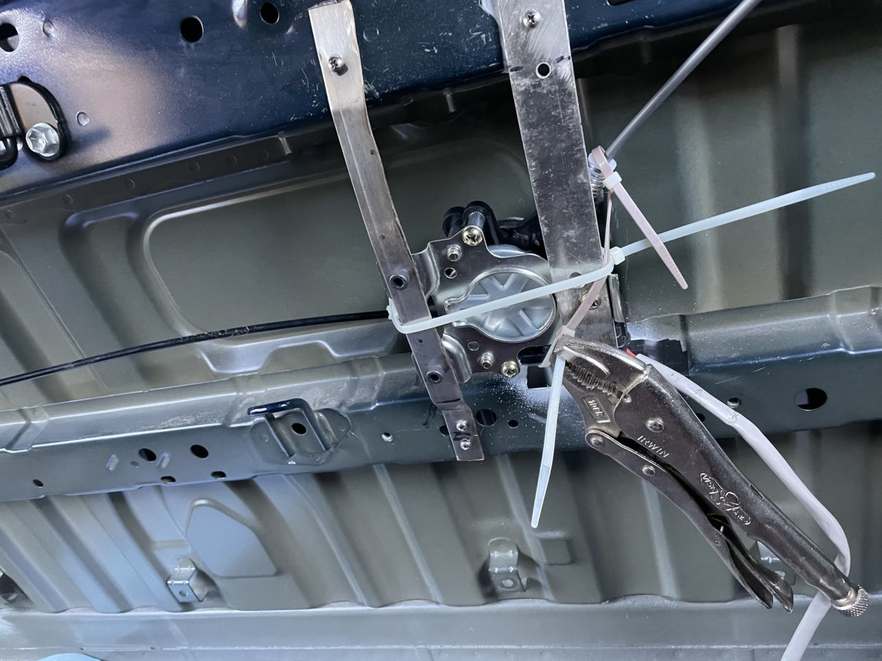

    Supercharger, flowmaster exhaust, 4runner disc brakes, Volant CAI, ECGS bushing

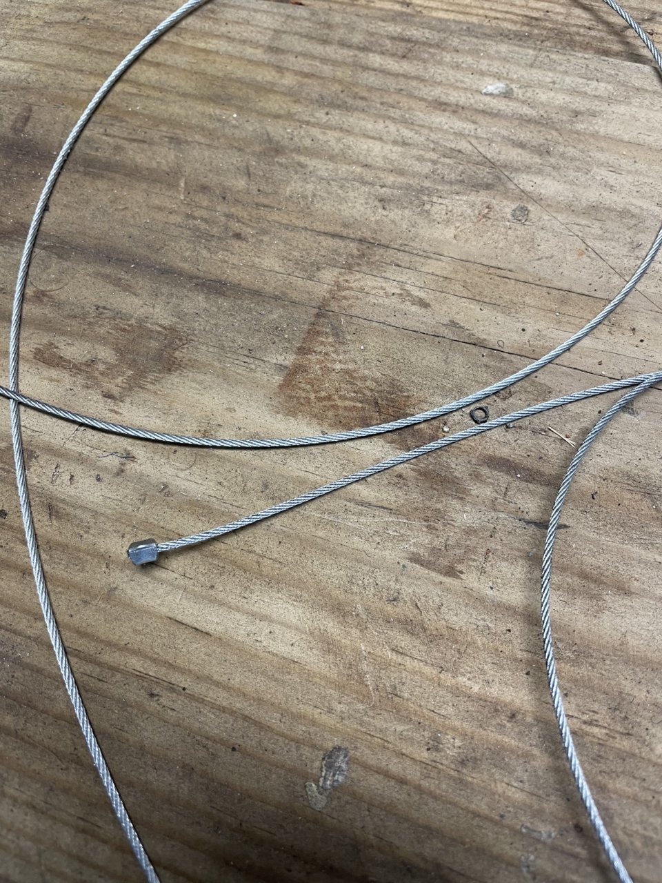

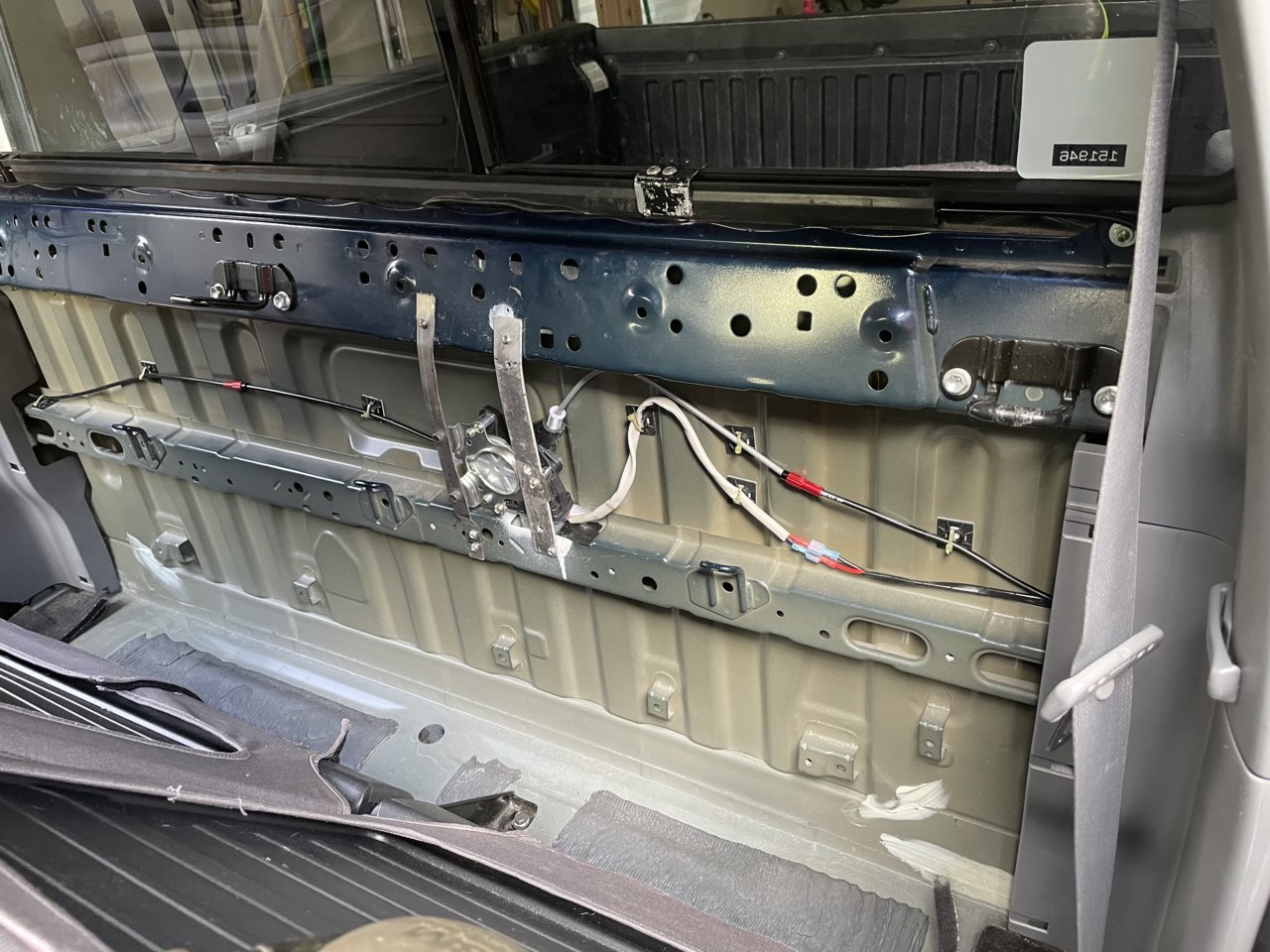

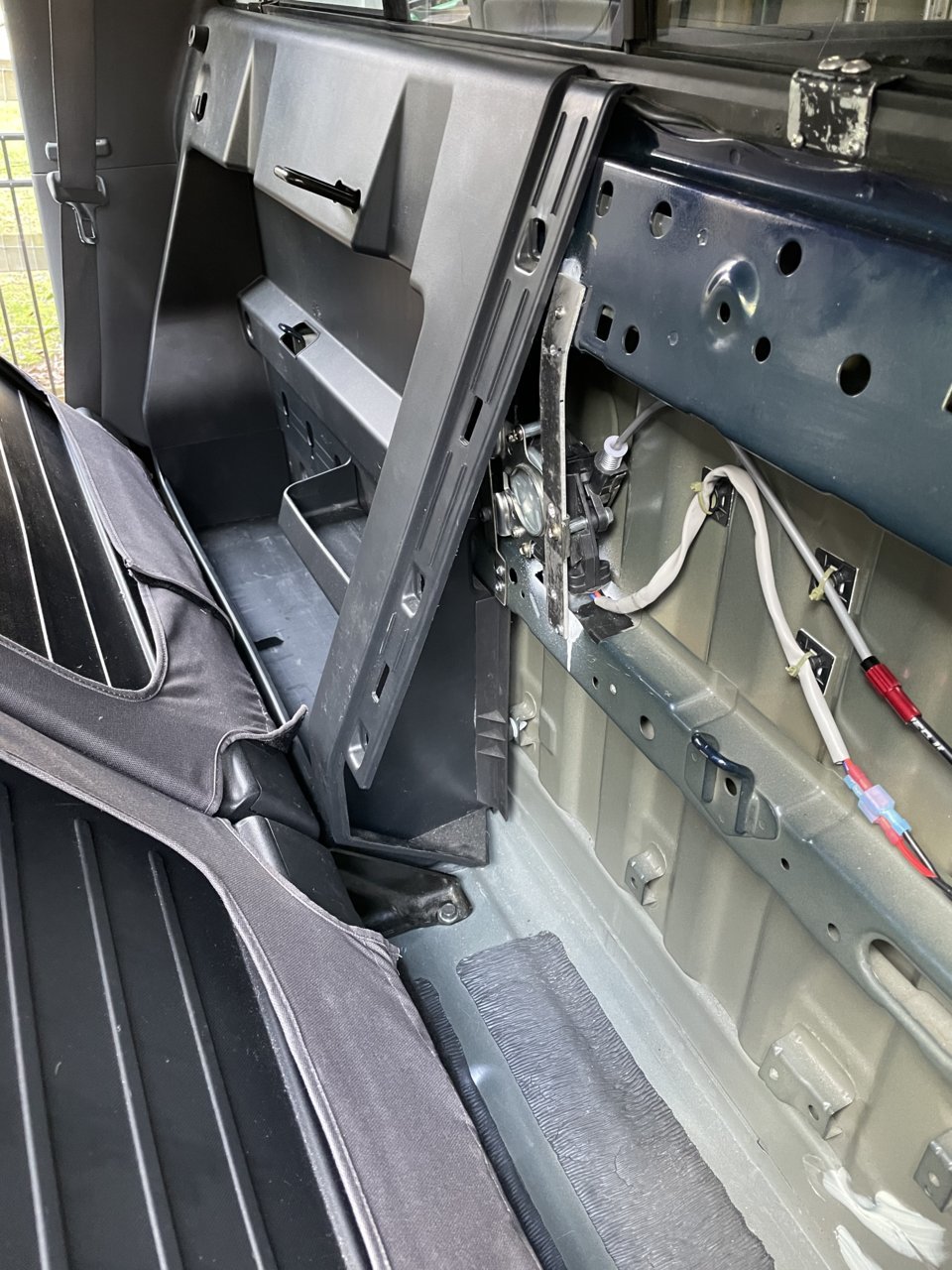

    Yessss, I got mine working. Thank you @Poitrasbh and @kgarrett11 and of course @BenWA.
    This was not a particularly easy modification, but in retrospect was not that bad either.
    So I did a few things different. 1) I didn't drill anything to route the cables, and just stuffed them behind the plastic coverings. 2) I used tie downs to secure the cables, 3) I fabricated a couple of brackets for the Front Left Power Window Regulator with Motor for 2000-2004 2005 Chevrolet Impala and cut off the single bracket piece to make it fit. 4) I used the sienna switch and this wire harness worked perfectly https://www.ebay.com/itm/Wire-Harne...lation/262291208817?ssPageName=STRK:MEBIDX:IT 5) I used 1/16" aircraft cable which was a perfect match and ferrules from tractor supply.

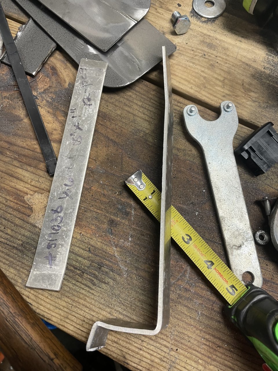

    Lessons learned: 1) I did end up needing to cut into the support bracket to get the motor to fit, 2) I was an idiot and had the cable wrapped "long" on the side that needed to "take" - just have a single wrap on the passenger side, not the driver side. 3) The angled heated hook worked well for passenger side to melt a hole for the wire, used an old drill bit (heated up) on drivers side to accommodate the bicycle cable housing. 4) It's not critical the motor is mounted once everything is measured (discovered this during my SNAFU with the lengths). 5) I just wrapped the wires for control of the motor with electrical tape for a cleanish look.

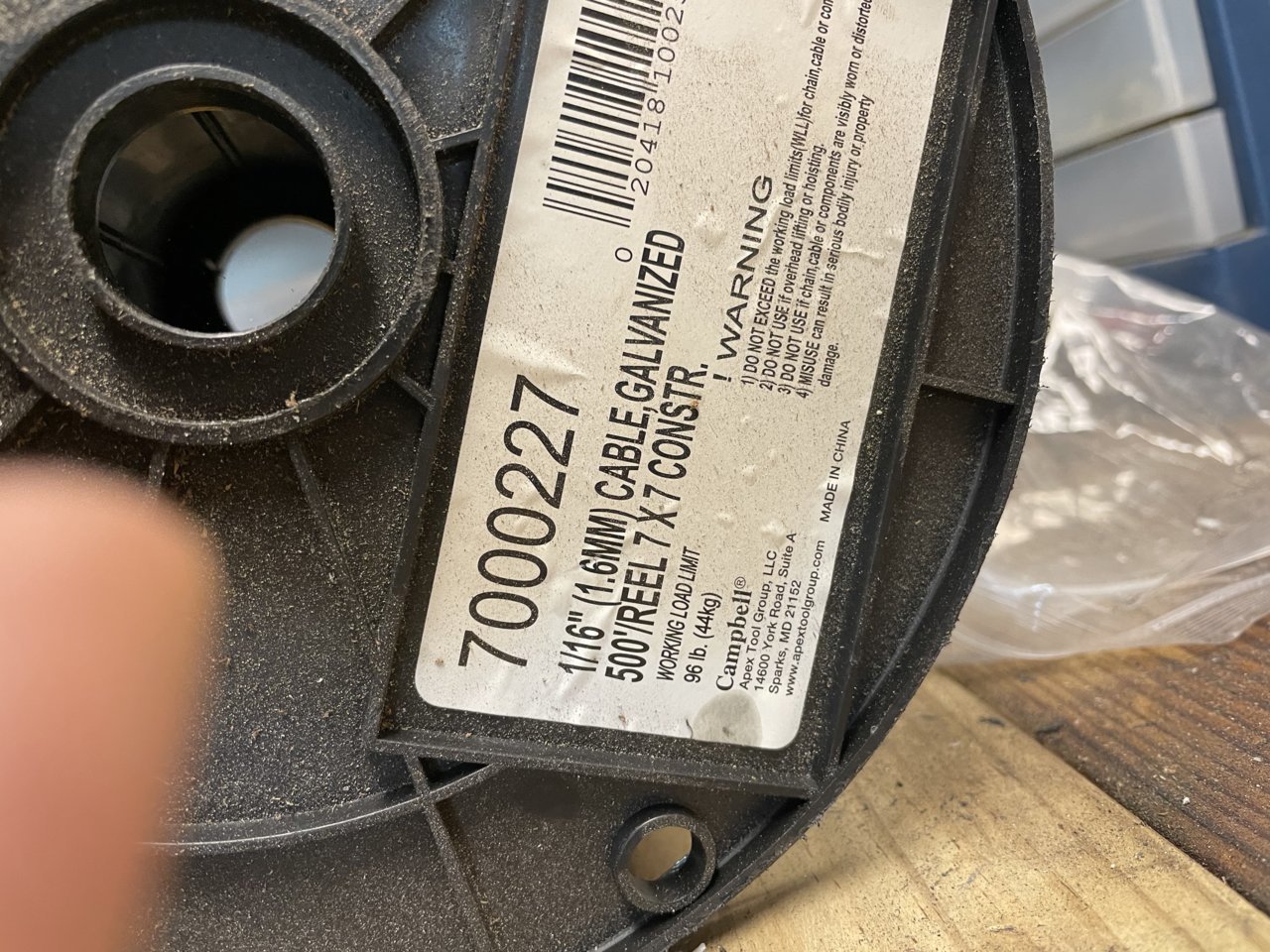

    I had some aluminum and steel laying around I used for my motor brackets. #6 and #8 screws to secure it. I also had a large supply of the galvanized 1/16" wire laying around.
    Overall with the bracket from Kgarrett11, I spent around $150 bucks in parts. Fabricating the brackets for my impala motor and the stops for the window slide were by far the biggest PITA. The Sienna switch works great and is mounted over to the left of the steering wheel were no kid will touch it. The deslacking process was not as bad as it would seem. The filing of the ferule worked really well, better than dremel. The correct ferrule came from tractor supply. the 1/16" wire matched the original perfectly. Don't be afraid to take the motor apart. The impala motor worked fine and at $30 was much more palatable than the ridgeline (especially if you mess it up).
    It took me probably 10 hours of labor with errors. I did it a little at a time. I could probably do it now in 5-6 hours. I'm really happy it is working and completely hidden. I had some doubts along the way but it works great, The only thing I have left to do is fix the taps for the illumination of the sienna button... I tapped into the wrong thing. If anyone knows wire color I'd appreciate it. Green and Green stripe are what I'm looking for but getting multimeter out and will figure it out.
    I uploaded a bunch of pics, can't get the movie of the slider in action to work though.

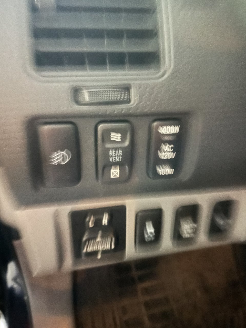

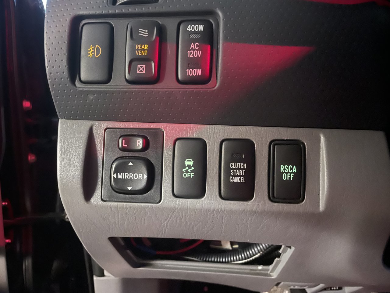

    Got the illumination fixed on my switch. Turns out the wires were correct, just the tap wasn’t engaged.
    I replaced the bulbs on top with amber leds from superbrightleds. The green lights also, I needed a replacement bulb, the part link is below.
    still loving this mod. I may make a video as I think it would help answer the questions I had at the beginning.

    Tint, headlights wrapped & rear lights smoked, power outlet mod., grill & rear bumper wrapped, Falken A/T 3W,
    what if I had a molle panel behind the seats? Im thinking it won't work? Anyone have a molle panel behind their seats that did this mod and was successful?

    An angle grinder with a cut-off wheel is your friend. Test fit, trim, test fit. Rinse and repeat until everything fits. Use black fabric or sound deadening to cover up behind the molle panel for a clean look.
