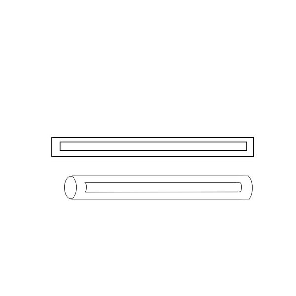

    Why not just have a round tube with a slot for the rack mount to slide back and forth in. then you could mount the limit switches in each end of the tube. It would look cleaner, and possibly safer than a open screw turning that could catch something.
    Like a C shaped tube but only where the guide had to slide back and forth in.

    Drawing kind of sucks, but like below.....

    Let me think about this one for a bit. If we relocate all of the brains off of the motor housing, we could get away with just power and ground and just have an additional piece off to the side that talks to everything else. Might work out. This is why I love doing this stuff out in the open. I could have had a power window in my truck two months ago and just lived with the little quirks, but when you do something out in the open and get everyone's ideas it just ends up better.

    Good thinking. About a month ago, I went out to home depot and found some PVC to experiment with just this idea. I cut out a channel, mounted the rack (eventually tried to use it to house the lead screw too, but it ended up being too large and it made the screw sound like it was hooked to an amplifier) . I could get it to work once or twice, but just couldn't get past the material limitations of the 3d prints. Rack and pinion really wants to be aluminium or injection molded plastic.
