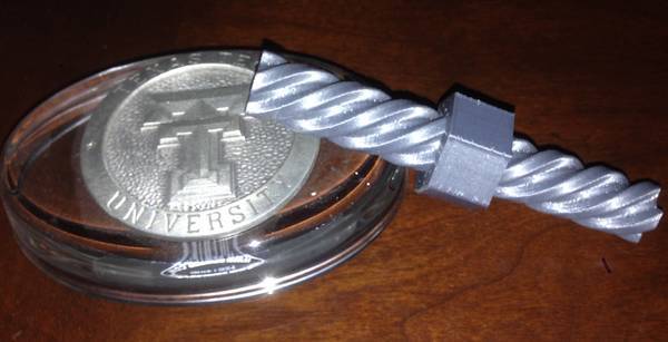

    Hey Scratch, I've been experimenting with 3-D printed lead screws. Here is one that I printed for a different project. It is setup to be 1 turn per 50mm, so it shouldn't require a super high RPM motor to travel the distance needed in a short amount of time.
    I'm experimenting with how to accurately combine multiple prints as my build capacity tops out at a 200mm lead screw which isn't quite long enough for projects like yours.
    Just a thought, might be cheaper (and more customizable) than $100+ steel lead screws.

    Your timing is remarkable. I was just thinking about trying to do a printed screw in Nylon with a 3mm or so hollow core that I could run a threaded rod through. That way I could print the screw in segments and use the rod to join them into longer distances. Are you using OpenSCAD to make the screw?

    I like the idea of using threaded rod to join the parts together. I was experimenting with glue & pins today but didn't really like the outcome.
    Yeah, I'm using OpenSCAD to modify the screw. I didn't create the original design, it is from thingiverse (http://www.thingiverse.com/thing:608282), but I'm tweaking some of the dimensions and trying to integrate a motor coupler directly onto the leadscrew to reduce the number of parts needed.

    I printed 4 of those leadscrews unmodified and joined them together with some all thread. Works well, just needs a few tweaks. I think your idea is the winner.
