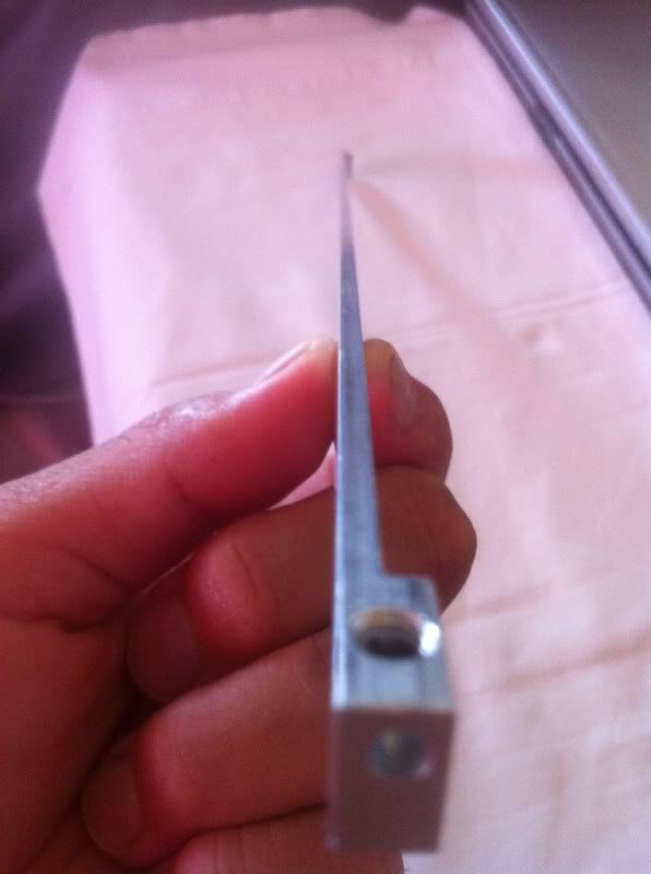

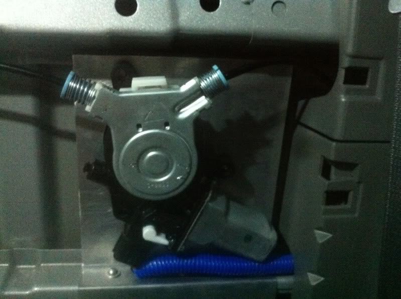

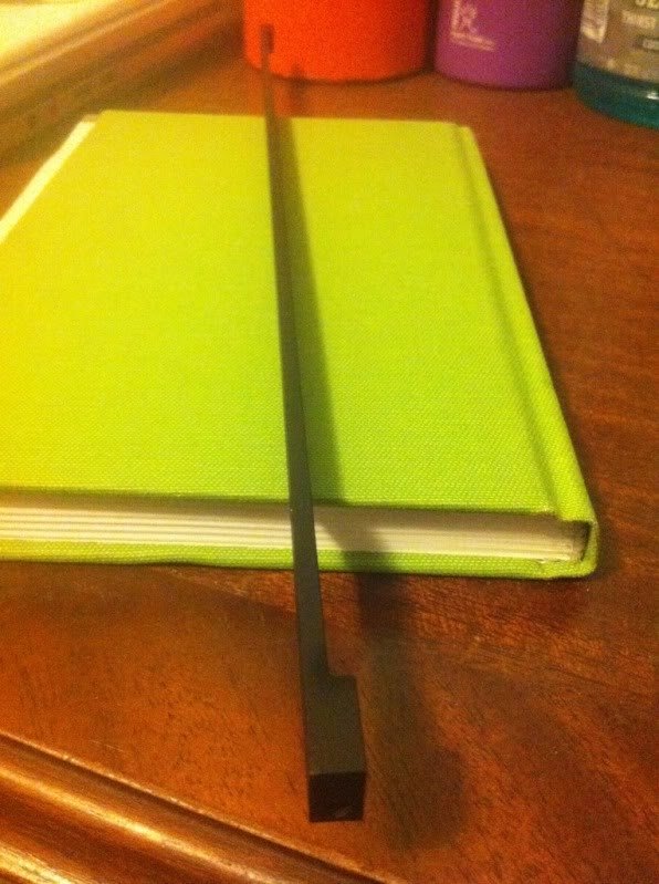

    Here was my set up on my 08 Access Cab.
    Ridgeline rear window motor regulator. Ran bicycle break line that was hooked up to a bar that was wedge between the window and the trim.

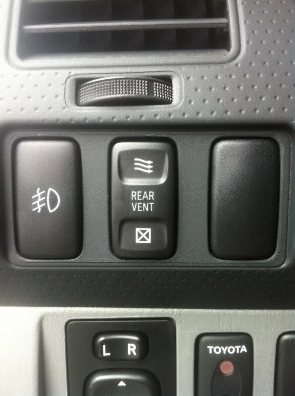

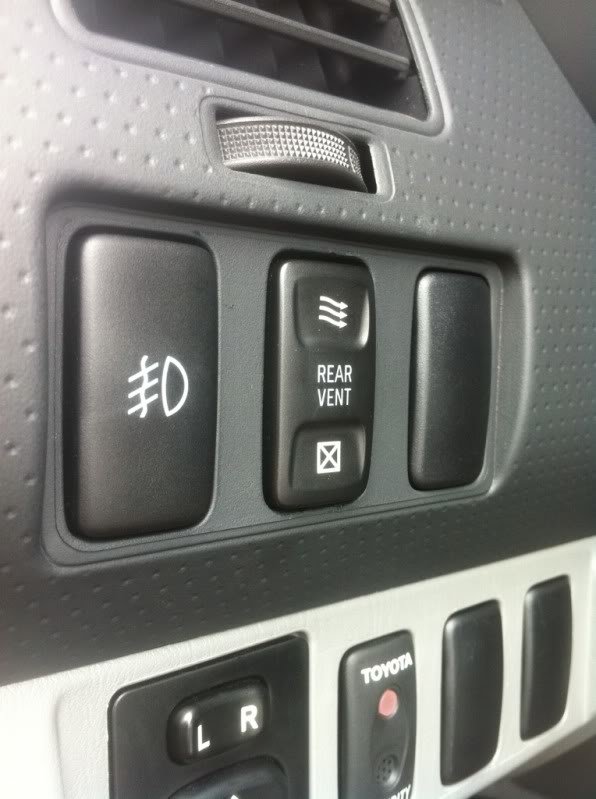

    Use a last gen Sienna rear sides window vent switch.

    The part that slides into the track, did you get that from benwa and thats exactly what i was trying to do but I couldn't get much into the track on my 13

    Yes sir. If I'm not mistaken in his original thread he shared the exact measurement of that part. If you got the right tools I'm pretty sure you can make one.

    Very nice, where did you get the switch ?

    eBay
