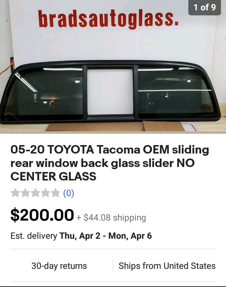

    Does it actually include the motor, etc to function or is it just a sliding window spec’ed to fit the Tacoma’s equipped with the slider motor and cables?
    my guess is the latter

    He(Brad) has youtube videos on the center glass install as well. You have to remove/replace the catch to get it in the channels.

    The window in the picture is a manual slider, I wasn't sure if the vendor (Brad) made an error in his description or not, which is why I started this thread.
    I did further research and found the fixed window has the same on from 04-18, so I went ahead and bought the new one.
    The window I'm getting includes the complete window, cable, gear and motor. MSRP +/- $950.

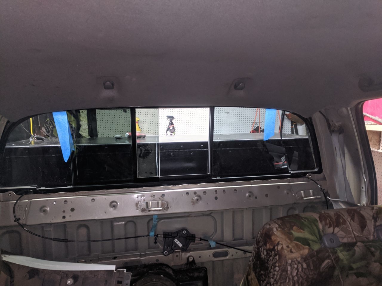

    I bought my 2017 power slider on ebay, no motor or switch/harness etc. Just cable/spool and window for $265 shipped to my door, pulled from a salvage truck. Required zero, zilch, nada, no modifications, it goes right in and fits like it should in my 2006 DCSB. Only pita is getting the old frame out. I've started running the wiring, and looking for a deal on the 2017+ Tacoma or the tundra crewmax power slider window switch.
    Im waiting for warmer weather to complete as the sealant requires temps above 50°f to cure properly.
