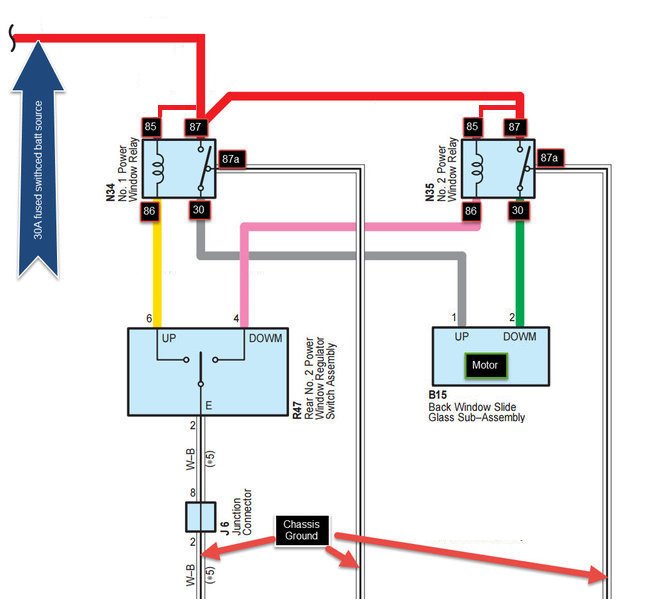

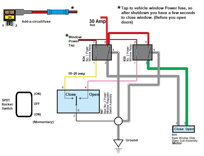

    Yes and yes. Use smallest wire on 85's. (20~18 awg)

    Hmm the pre made wiring harness I have for 5 pin relays are 12 gauge wire I believe, and I for sure stepped down to a 14 gauge wire from there. Do I really need to run that small of wire? In other words should I take the factory pin out of the 85 slot and redo it with smaller gauge wire.

    Yes
    86 to switch should also be of small gauge...

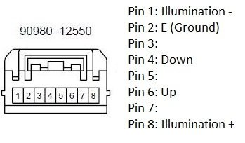

    Those harness connectors use female spade connectors with a locking tab. You can slide in a small flat blade screw driver to release them and some auto or electrical parts retailers have them loose.

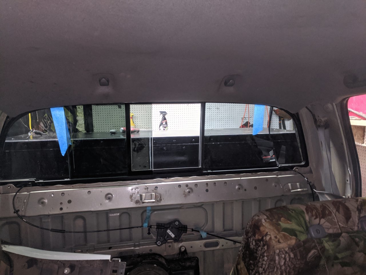

    :gossip: if anyone's interested..... The 2017+ power window assembly fits into a second gen double cab, and I don't see why not all cab styles 05+. Mines an 06. I bought one used complete with cables, I just need to buy a switch, the motor and run the harness.
    I did need a new back window anyways and after looking at it and looking some more, I found one for $330 shipped to my door.

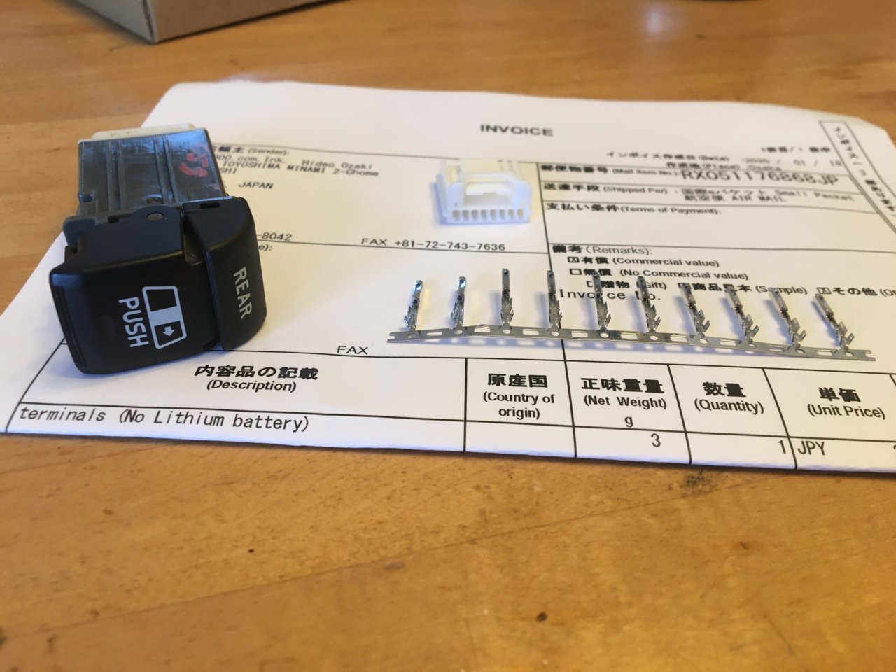

    connector and terminals came in the mail today, straight outta japan.

    question for anyone running this switch, does the lettering and symbol light up on this guy or is it indicator window that lights up.

    Get 9V battery and juice pins
