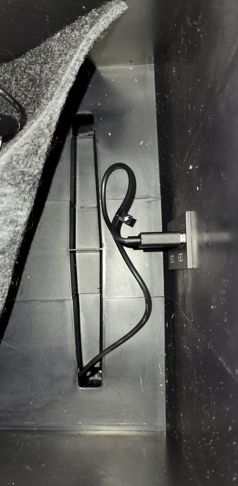

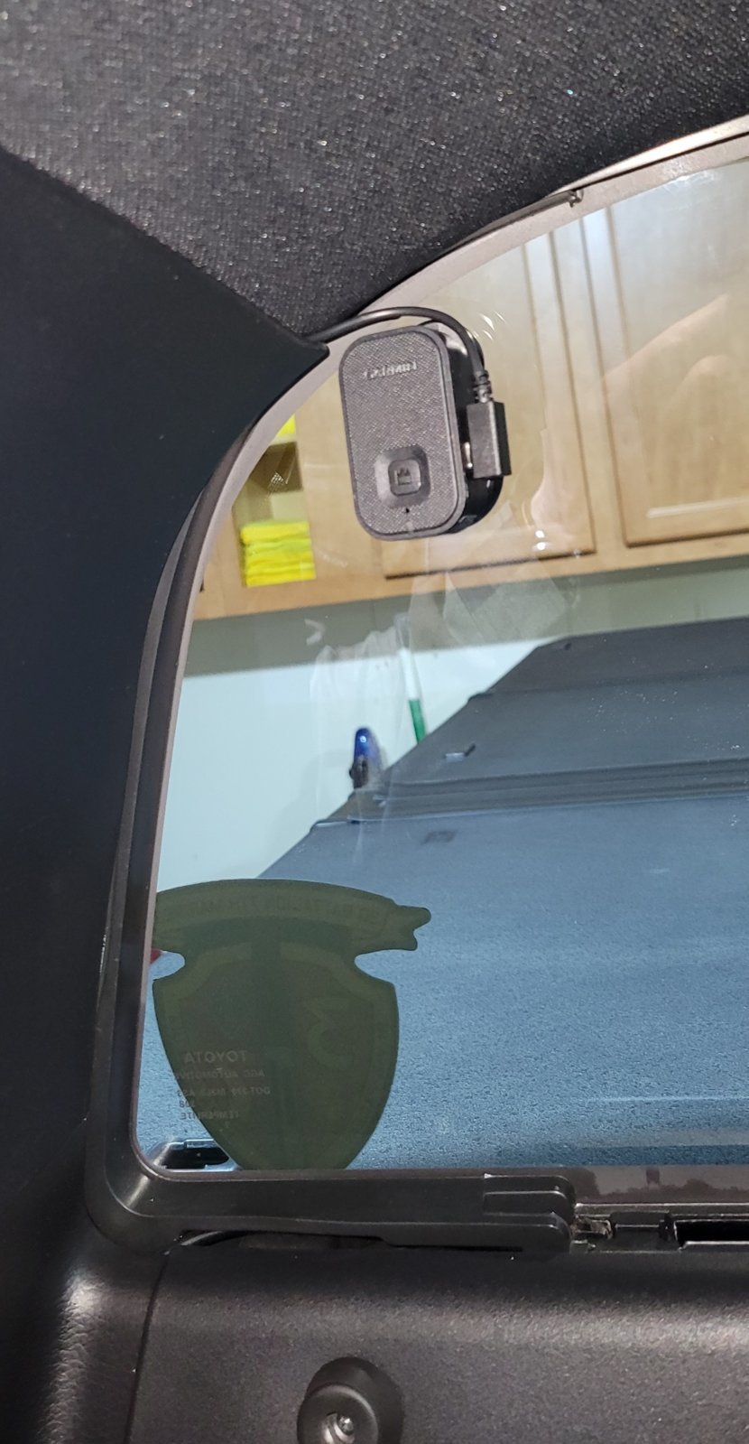

    Thank you so much for the help and photos. But I ended up taking out all the side panels, undoing the rear passenger bolts on the front passenger seat, and using fish tape to get the dash cam power cable under the carpet. I then got it under the center console and plugged it into the USB port. I put everything back together and hid the wire behind the panels. I do realize this won't work with the parking function, but I'm okay with that.
    Thanks again for the willingness to help. Also no fuse.
