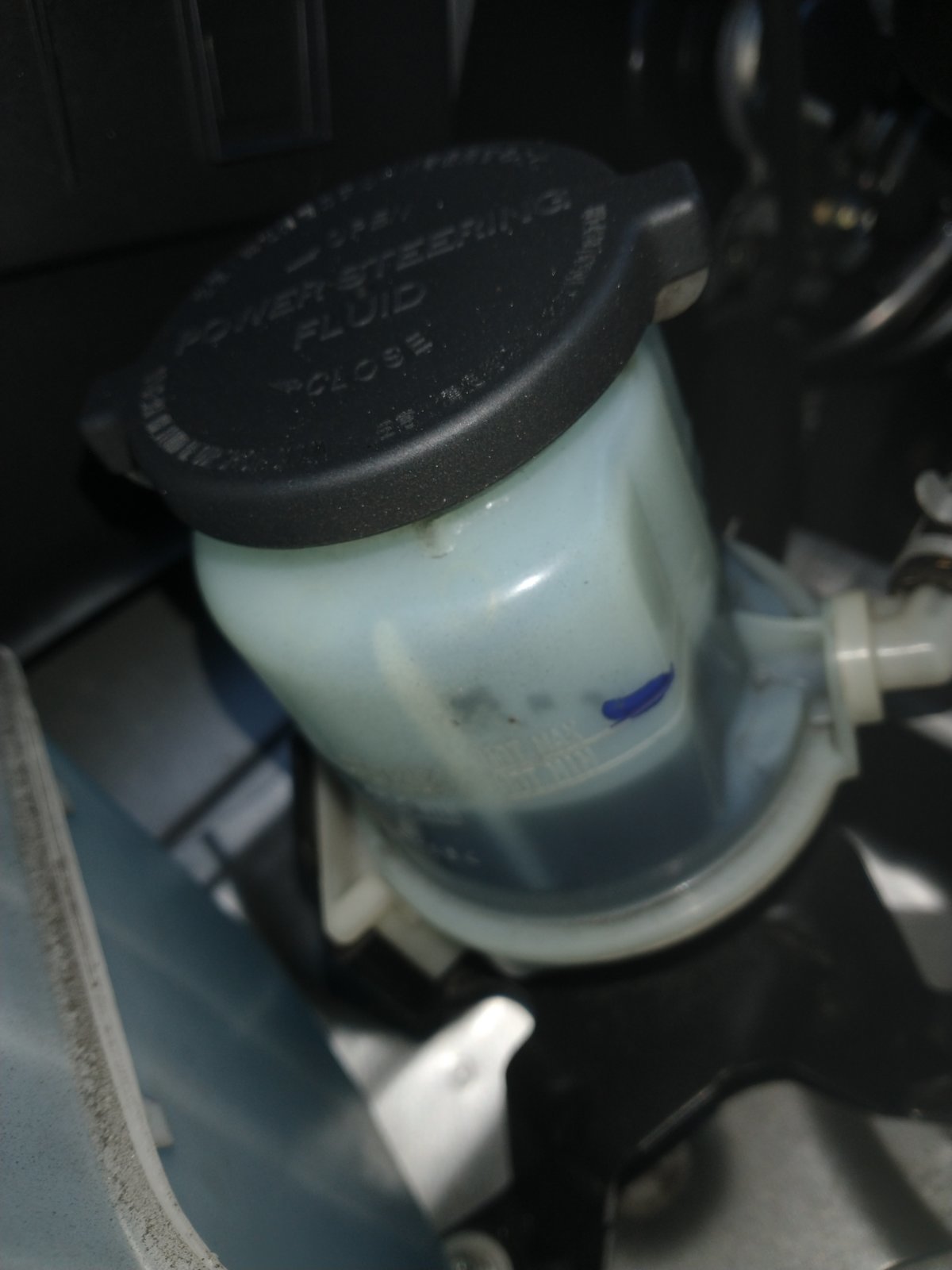

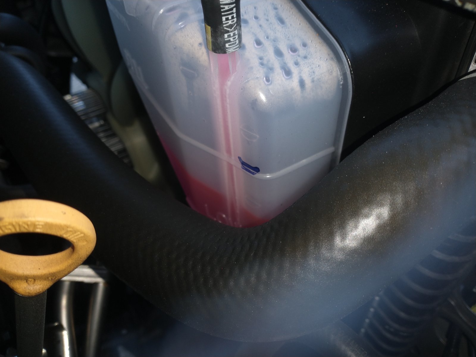

    Scrubbed some tires, and knocked a dent out.
    Recently picked up a 23 OR. Ill be honest, I looked under the hood, and under the vehicle. Obviously wasnt a full on inspection, but I pulled the trigger after a few months of searching. I made sure to buy one with the toyota used warranty. It is still under factory warranty as well.
    Having a day off, Im going over the truck. Im very embarrassed to notice two blue sharpie marks that I didnt notice before. The photos provided show the levels cold.
    Maybe the marks were taken warm. Im certainly going to check that tomorrow when I use the truck again. Im just a bit worried as to why they are there. Im hoping/ assuming it was just part of the check list to certify it for the used warranty. But the marks are only on these two tanks.
    Does anyone know if these marks are standard practice to certify. Ive put about 2k miles on the truck and havent noticed any issues, but this is admittedly only the third time Ive raised the hood.
    Thanks

    I guess I should add that both are below the low mark, which I assume (especially with coolant) that thats when they should be measured.

    Off the top of my head. Some of my marks are “Hot Full, Hot Low”, “Cold Full, Cold Low”. Others are “Full, Low.” My guess temperature is more critical on some than others.

    Yeh. Now Im looking at the photos I took and see that the power steering one clearly says hot. lol
    Idk, just trying to catch anything before warranty is up. Gonna check the diffs when I can.

    You could crawl under and see if you have any active leaks.
    But all you can really do is, fill them up to the proper level and keep an eye on it.
    Well, maybe you shouldn’t do it. You could let the dealership do it.
    That way they have notes if the fluid continues to drop.
    Williston and TheWildMan[OP] like this.

    Coolant reservoir level will fluctuate depending on how much is currently sucked into the system. Dexron 3 ATF for the power steering fluid, although some dealers use plain Johnsen's power steering fluid.
    You could top both off and if they drop again take it back to the dealer. Have them note it in the system/inspect the truck for leaks.

    Both are fine. Read your manual on how to check the fluids.
    They have ranges, if you had both set to max they would be overfilled in the summer.

    Maybe someone put the marks there to make them easier to see or they are just part of their pre-check delivery process. Before you add any fluids, check the levels when the truck is fully warmed up from a good drive and fill them to the "hot/full" line if they are low. When the engine is cold, the levels should be between the MAX/MIN line (p/s), and about halfway between the LOW and FULL line (coolant). IMO: the coolant level looks ok. Look for another line under where it indicates "LOW". You may have to look at the far side of the bottle near the bottom. Take care not to overfill the p/s fluid. It's easy to do because those lines probably represent less than an ounce. Check it when it's hot and running.

    All the Toyotas from the Mexican plant have those sharpie marker lines on them.
    I also have a bunch of graffiti written on my frame.

    More than likely they (factory) marked them when it was fully warmed up as a final verification. I think you're good on both, but run it by the dealer. That's what
    brandy-new truck warranties are for! :thumbsup:

    it's good to keep an eye on fluid levels, however, being that you didn't make the marks, you also can't know the conditions they were made under. the truck might not have been level, or at a different operating temperature.
    i would recommend spraying some brake cleaner on a paper towel and cleaning those marks off, they're only going to mess with you more.
    it's not a bad idea to have marks there, and make your own, but my preference is to make those marks when the vehicle is cold, and in my vehicles garaged parking spot-- that way, any pitch of the area i'm checking is accounted for, and i get a more accurate reading.
    i would suggest to continue to keep an eye on it, my '14 brz when purchased new, was down to zero coolant in the reservoir after 3 months, but i had never checked it before that time, so it might have had an air bubble from the factory, and since refilling, it's never fluctuated much since.
    but all fluids are going to fluctuate a little depending on hot/cold/running/pre-start, and in the case of fluids like antifreeze, it has a water content that will gradually boil off over time as well.

    If you are in a cold or extreme-cold weather area, that coolant level in the bottle can drop a lot after the truck has been sitting. Mine usually sits about half-way between the indications this time of year, but when it drops to the teens, single numbers or below 0, it can retreat to just a couple of fingers above "LOW" line. It always recovers to "FULL" if I happen to check it when the engine is hot.

    My truck had the same mark on the coolant reservoir when I bought it new in 2020. It was built in Mexico. I don't have any coolant leaks. I had it inspected while it was up on a rack yesterday. Interesting that SH10151 posted that all the trucks from the Mexican plant are marked the same.
