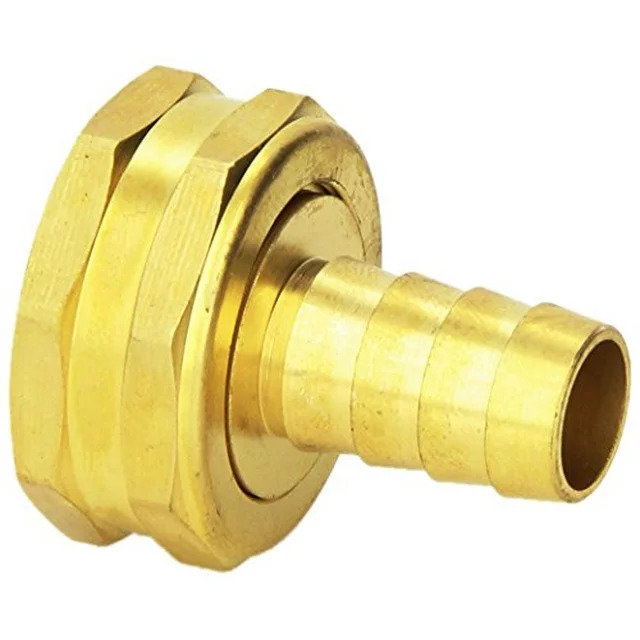

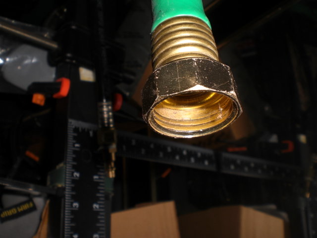

    Had a tough time finding anything other than HEx ....
    until I relized that most water fittings are octo....
    So a hose repair from your local ace might be solution...
    the outer demensions I found on the one on Amazon was 1.25in by 1.25in
    1/2FEM BRASS HOSE END REPAIR - Walmart.com

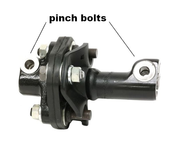

    First we're hoping to avoid removing these, but yes, and there's actually 4 nuts and bolts holding the rag joint together, you probably can't see from whatever angle you're at. Feeling your pain, I had to cut mine out and put in new ones.
    As above, hopefully no. The pinch bolts are the ones above and below the joint itself, clamping both the rack and the steering shaft by the splines.
    You should be able to remove those bolts and slide the entire assembly UP the shaft, out of the way, to free the head of the rack shaft. You want to remove them because there is a slot on one side of the shaft and the bolt goes through it, it won't move up with the shaft the bolt is in the way, second pic.
    The rag joint will be rusted too at the splines, use lots of PB blaster and gently tap from below, it should start to slide up.

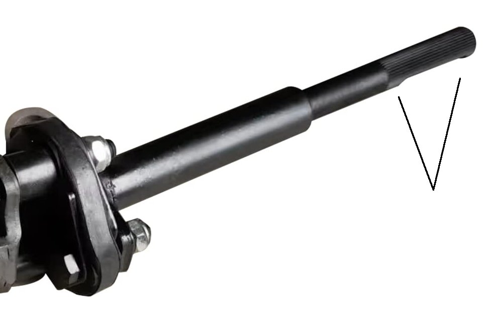

    Below is what the shaft looks like without the joint on it, see the slot at the spline end? That is where the upper pinch bold slides in across the lower steering shaft. So if you don't remove the pinch bolt, it will go up a little and stop. Hopefully you can get it to move up just enough to free the head of the steering rack shaft.
    Sadly, if you can't get it to slide up, you may need to address the bolts/nuts holding the joint together. and separate the joint. Be sure to mark where everything aligns before you do.
