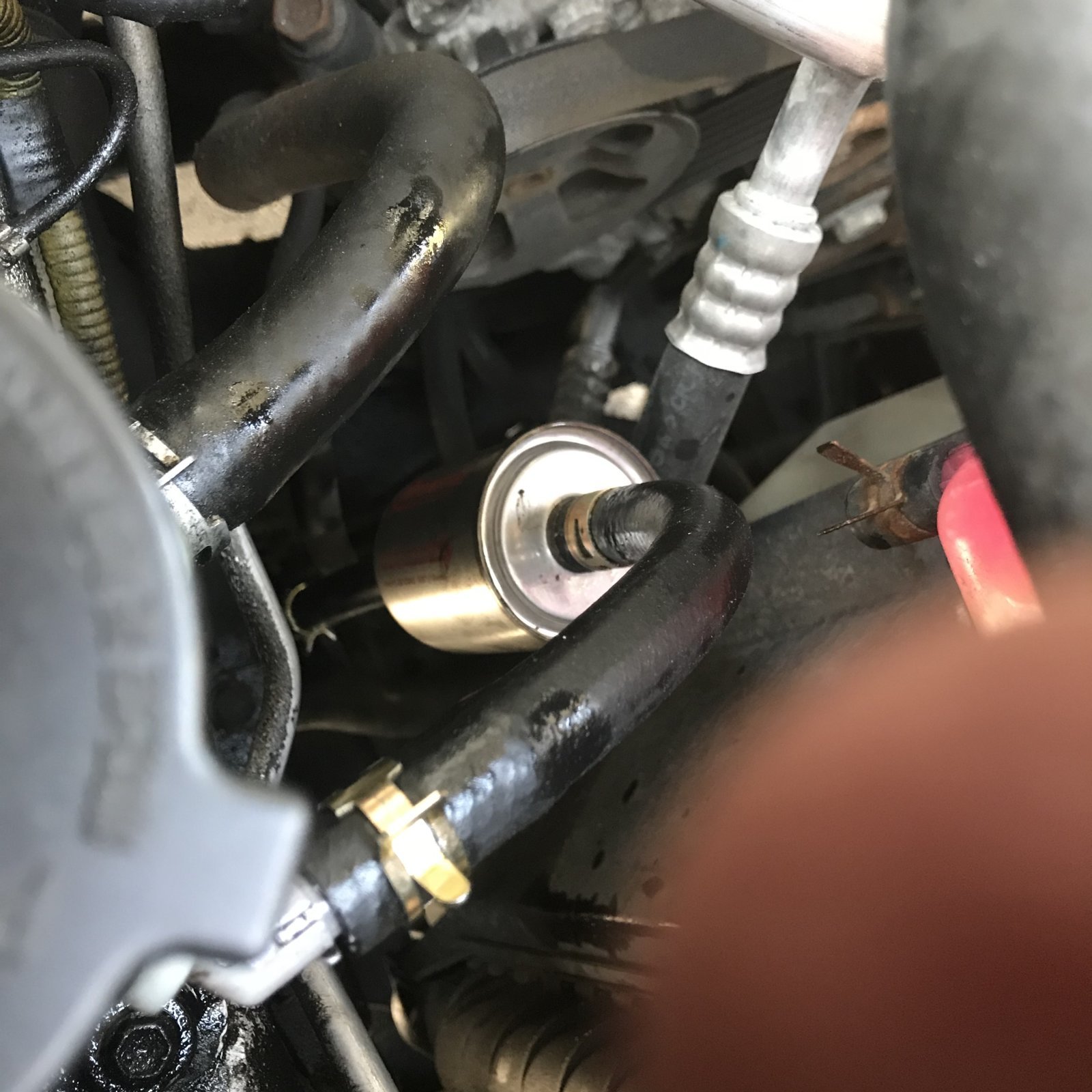

    Add an inline filter since the PS system has no real filter at all. The screen in the reservoir is just to keep the boulders out

    Boulders refers to any particles larger than 100 microns. The same filtering level as the pan filter in Automatic transmissions. Didnt say this was the fix. But is a worthwhile addition after system is working again.
    And adding a filter where this is none is in no way "excessive"
  14. Jan 30, 2024 at 10:09 AM
    babylon5
    babylon5 Well-Known Member
    Aug 19, 2015
    #162175
    917
    David
    2015 Tacoma Double Cab TRD Sport
    I use a magnefine in both the ATF cooler loop and the PS return line. 3/8 inch version.
    https://www.amazon.com/dp/B0787KWZPS
    Excellent article by two automotive engineers that did testing on the affect of contamination on the life span of both Automatic transmissions and Power steering. They also recommend the magnefine.
    In nearly 30 years of study, engineers John Eleftherakis and Ibrahim Khalil defined the failure modes of automatics due to contaminants and determined the typical types and allowable amounts of contaminants.
    https://www.motortrend.com/how-to/129-1002-automatic-transmission-and-power-steering-filters/

    +1 on the filter. May help any contaminants from re-entering the pump.
