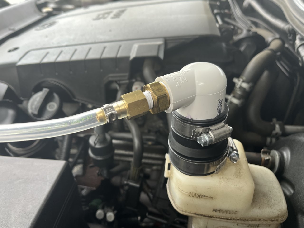

    I recommend the Motive pressure bleeder and I built the master cylinder adapter myself to save money over buying the $70 plus adapter, but I included a link for that as well. I haven’t used the pressure bleeder yet, but I tested the pressure hold of the adapter and it worked!
    https://www.amazon.com/dp/B004IQ96RK/?coliid=IQ7NNZSA8A82G&colid=2NZ8N1O688GE3
    https://www.amazon.com/gp/product/B00CJ5DWKO?ie=UTF8

    Please provide description or part numbers of schedule 40 fitting and rubber sleeve. Thanks
