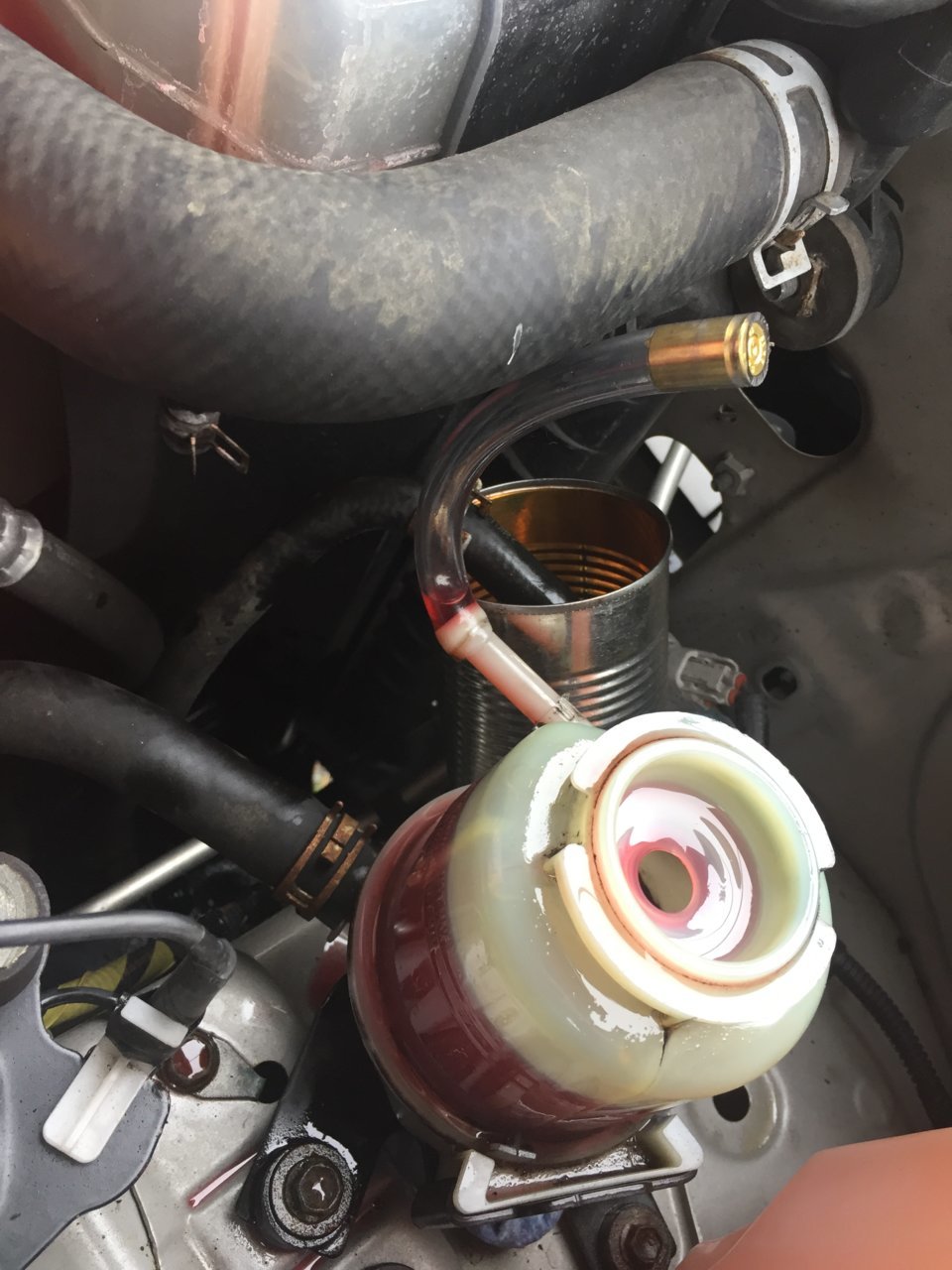

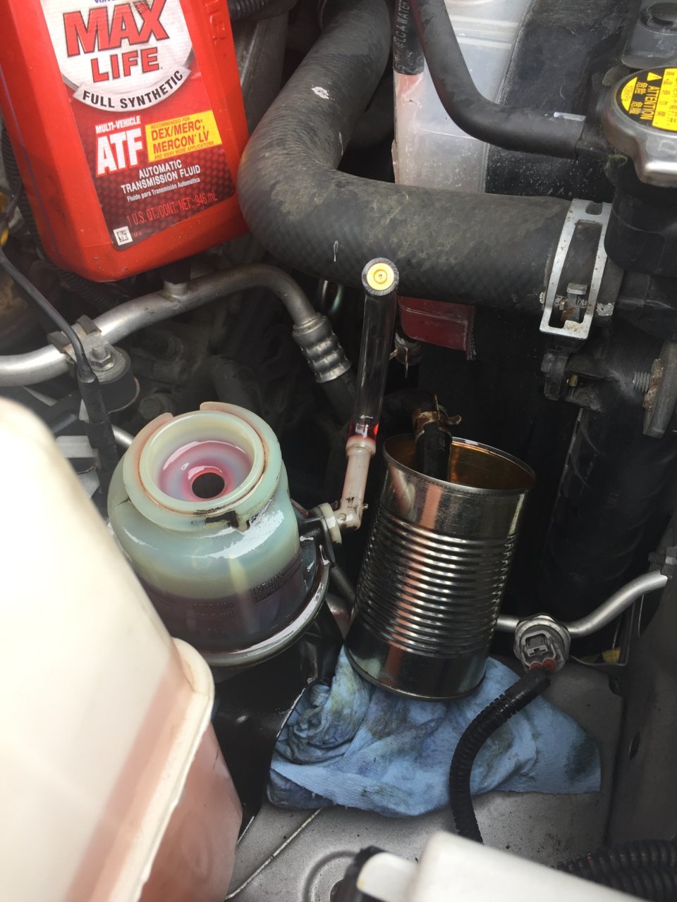

    Grabbed a quart of Valvoline Max Life ATF at the auto parts store for 8.03 out the door. Easiest fluid change i have ever done on my truck. 20min from cracking a pre work beer, to cracking the post work beer. Dont go full lock to lock as it will drain past what i would deem safe fluid res level . like 75% to lock each direction was perfect. 1 quart was the perfect amount.
    Again easy quick painless job. Ill be doing it as part of my every 30k mile rear diff fluid change regimen.
