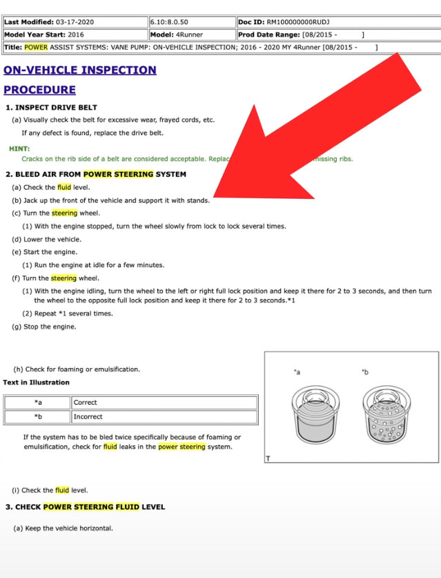

    My power steering always felt fine driving but had a whine to it. Replaced the fluid and the whine has gotten a lot better but it’s still there. I think I had air left in the power steering system so I did this procedure and hopefully that will take care of it.
