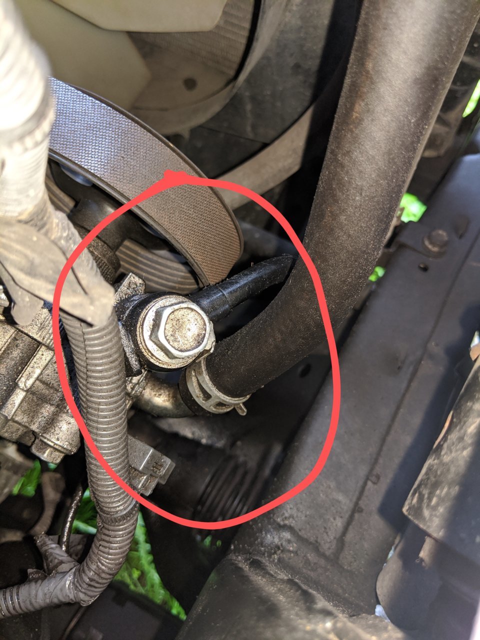

    Here is a photo with the return hose attachment point to the pump. Hard to tell if it is the return hose or the hose coming out of the pump with the banjo? bolt.

    It is probably the high pressure hose that's leaking- looks like it from the pic. I'm not specifically familiar with it, but generally they use a copper sealing washer on each side of the metal hose end. I'd try two new washers from the dealer and tighten that fitting with a torque wrench to the spec in the FSM.
    And maybe it's the angle, but why is it so close to the pulley?

    tighten up that banjo bolt holmes

    Do you have a link to this part?

    I have a 2015 4.0L 6 cyl and my setup is not at all like yours. Your lines are metal; mine are plastic.
    Either you have a 4 cyl or Toyota changed the power steering setup on the 4.0L along the way.
