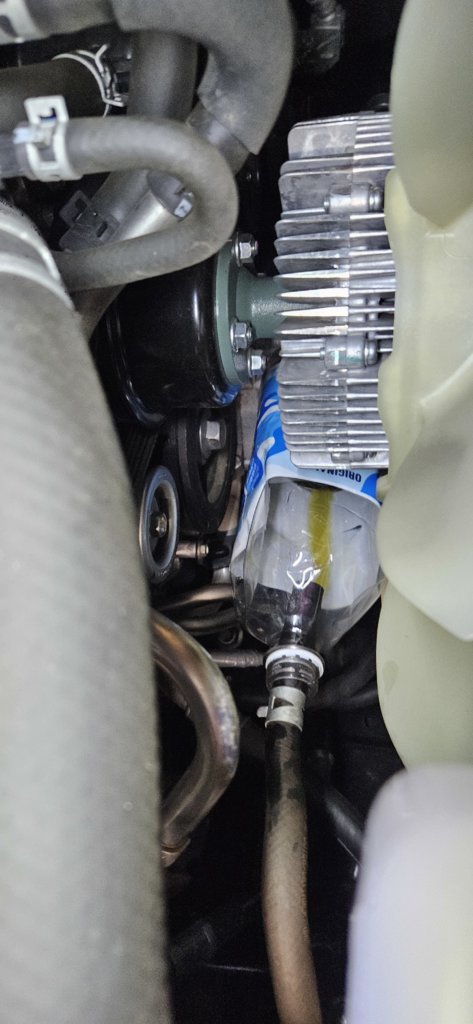

    Put the truck on jack stands, pull the return hose and stick it into a gatorade bottle and cap the reservoir with a 3/8" vacuum cap.
    Turn the wheel all the way to the left, fill reservoir, turn the wheel all the way to the right, fill reservoir, repeat until flushed.
    One complete turn all the way to the left or right will empty the reservoir, so keep it full during the flushing process.

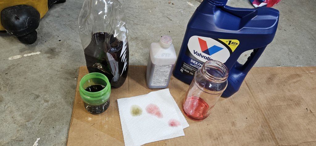

    I did mine a few hundred miles ago and Valvoline Dex/Merc which is Dexron III based. Because I wasn't using an "OEM" fluid, I wanted to fully flush the system and not mix old and new fluid.
    Popped off the return line and fed into a large plastic bottle. Lifted the front and just slowly turned the wheels adding fluid as needed. Went through just over 1/2 gal and will occasionally do a pump-out/replace.
    No leaks at boots before the change and none after using Valvoline either.
    Valvoline DEX/MERC (ATF) Automatic Transmission Fluid 1 QT, Case of 6 https://www.amazon.com/dp/B00DJ4FF0E

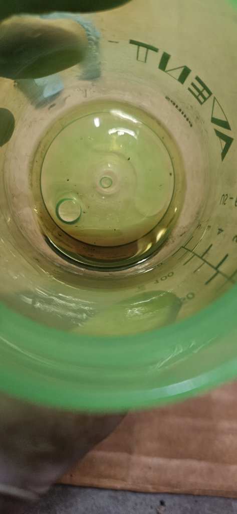

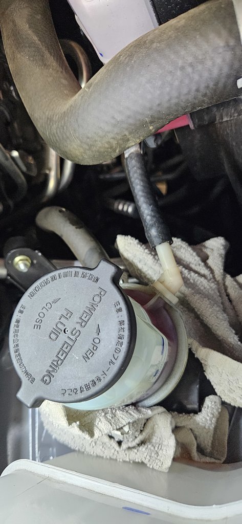

    I used a small piece of 3/8 hose with some backer-rod shoved inside. I've seen people use bolts, clamps... etc. Put that over the return tank nipple. I did suck out the fluid in tank before beginning flush. As you can see, there was debris and other crap picked up from tank so don't just start flushing the old fluid as it does have particles.
