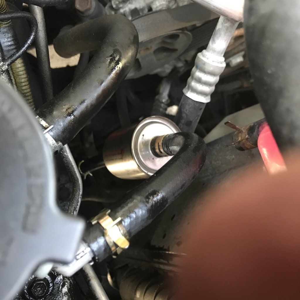

    As an alternative to raising the front and turning the wheels I do the following.I block off the return line at the reservoir, hook up a 12 volt oil change pump to the return line and then draw the fluid thru the system while adding new fluid to the reservoir. The old fluid goes into a catch bottle of your choice. Have found that the addition of a magnefine in the return line has also been very effective in keeping the fluid clean.

    Raising the full front end on the jack point (second gen anyway) allows making an easy full travel stroke of the rack in each direction. I used surplus ATF fluid in an attempt to flush the components a bit - so I did it more than once. The big question is - how would the system get contaminated anyway? On my wife's Dodge Charger the factory PS fluid eventually chemically failed the rack piston. The morons at the dealership kept telling her the ordinary PS fluid was "dirty" and needed changing. Changed it twice with recommended fluid. Replaced rack when it it would not steer the same in both directions. Rack failed again. Second time was the charm and we dumped the vehicle.... My Dodge truck instead used ATF (specified in the manual) and it stayed clean - start to finish (165K miles at trade for the Taco). Ordinary PS fluid is simply NOT the equal of the ATF. Imagine the difference in required seal protection of fluid in an auto trans - and the temperature stability.
    The Valvoline ATF I put in the Taco still looks like the day I changed it several years ago.
