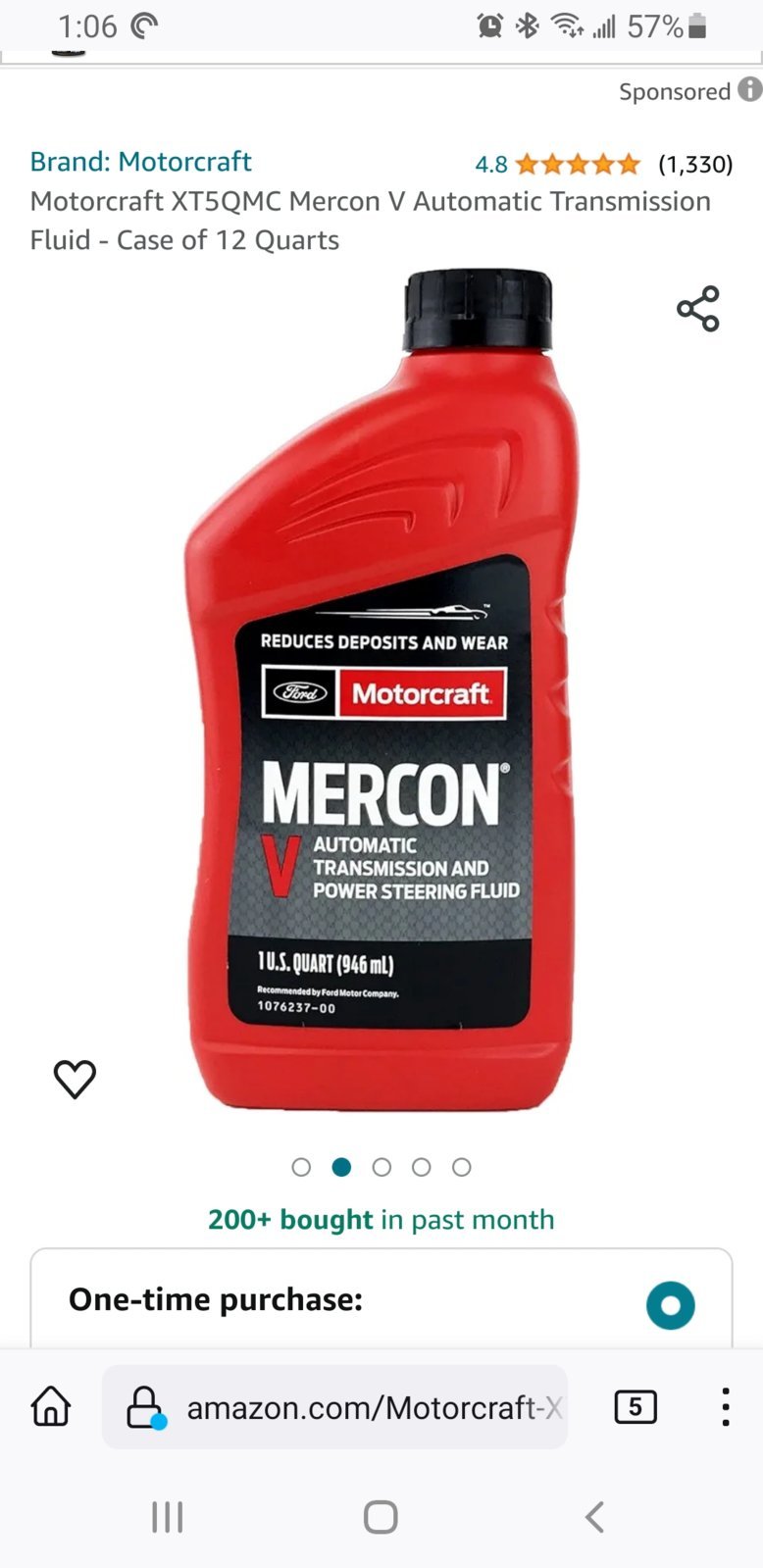

    Yep ford is exactly the same. For my 08 Tacoma I bought valvaline maxlife atf and use it for the power steering and transmission.

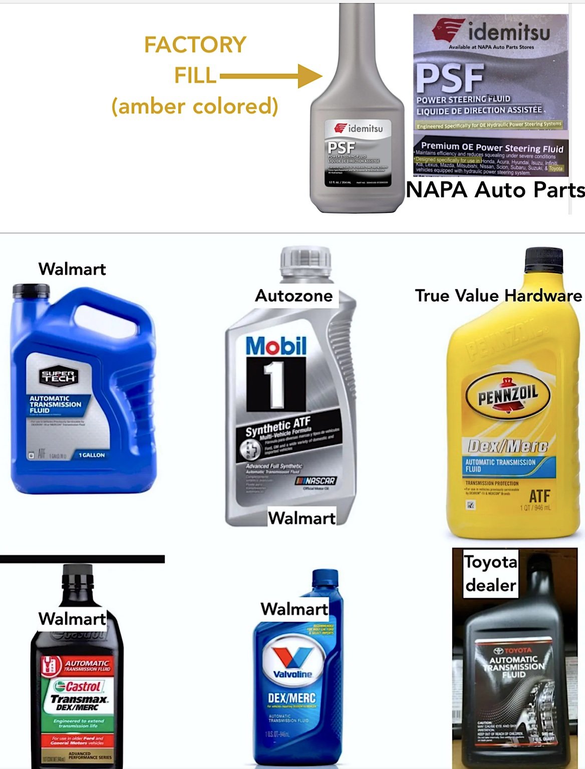

    Any of these red Dexron III fluids can be used as well as the amber colored factory original Idemitsu power steering fluid: amber.jpg
    DAS POWDER[OP] likes this.

    Confirm my 2020 has the exact fluid as in the photo.
