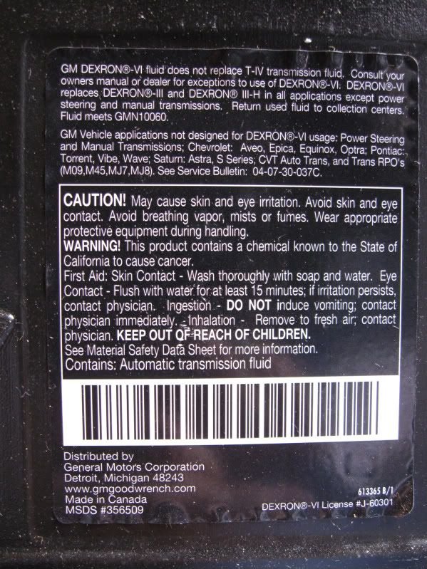

    That would be news to me. As far as I know they specific that they test everything GM related so in that regard the backwards compatibility is tested and approved, but nothing non GM related is approved since there are a lot of factors out of their control like seal/clutch compatibility. Realistically in my opinion this is just a way of avoiding law suits since they are not going to spend money to test for other manufacturers. When I see toyota spec'ing Dex 3 since the 90s in their power steering I always wonder what the point of it is, and what the hell theyre putting in there from factory since theres no licensing for it. I've been to dealers and they dont know what to give you, the same way they've tried to sell me ATF or GL-5 gear for my manual trans. IMO toyota needs to step up their game a little bit and update their spec sheets or atleast offer fluids. GM had a recall on the Enclaves where they switched out peoples power steering from the "GM/AC Delco power steering fluid" formulation to Dexron VI, as part of the recall they were replacing the rack and pinion and they made all kinds of warnings that the new rack shouldnt come in contact with the old fluid, to flush the system to dex 6 first otherwise the seals can get damaged. I know some BMWs called for some expensive ass CHF hydraulic fluid where as other ones called for dexron. There was some mix up by owners over what the cap said since BMW kind of used the caps universally and they had issues with the racks developing leaks. For the sake of avoiding expensive repairs and seal compatibility it's best to just stick to some sort of ATF. It's not the best fluid for a power steering system, but works.

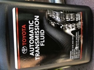

    Just picked this up from the dealer. Is this the correct power steering fluid for my ride? Hard to trust them.

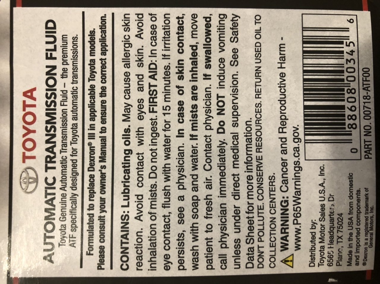

    Yes.
    It says Dexron III on the back, doesn't it?

    It only says Dexron. Just trying to make sure I have the right stuff.

    It says, "Formulated to replace Dexron III..."
