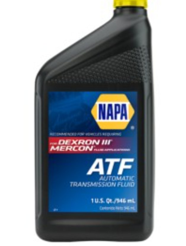

    Ha, I need that question answered too! Can't find Dexron II/III anywhere...only Dexron VI

    I have tried the red O’Reillys brand Dex VI, and it says it’s compatible with Dex II & III as well as Toyota WS ATF…
    Pretty sure the seals are not liking it in my 2012 Tacoma or my 1997 4Runner… as they both started leaking aggressively once flushed with the Dex VI.
    im trying to flush back to OEM Toyota & see if I can get away with that.

    I use Amsoil Universal ATF as its rated for Dex. Plus its what I had lying around. Every other oil change I extract the reservoir dry and refill with fresh.
  7. Feb 17, 2024 at 5:57 PM
    Ziggy16
    Ziggy16 Active Member
    Dec 19, 2021
    #385007
    37
    22 off road
    MastaZ9 likes this.

    You can use dex iv if the spec is not to be found. Ideally though some valvoline max life or something would be more ideal. From my experience the only issue i've found with the dex iv is that the steering is slightly stiffer due to the thinner fluid. If you live in a cold climate though, the dex iv is probably for the better
