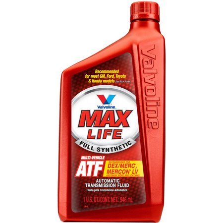

    Plain Jane Taco
    Plain Jane Taco Well-Known Member
    Apr 19, 2009
    #16179
    40,279
    USA
    Grab a couple of quarts of this and you'll be good to go
