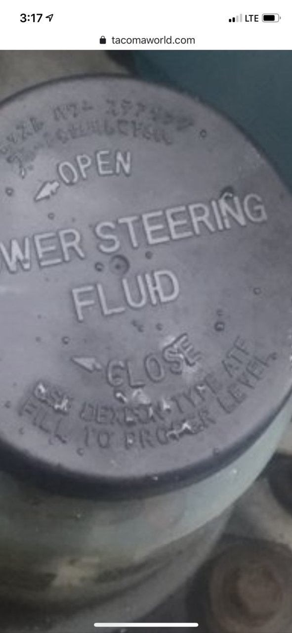

    EatSleepTacos
    Mar 24, 2015
    #151688
    59,841
    Randy
    West Valley, AZ
    2017 4Runner
    OP got his answer, but if you look closely at the cap underneath “close” it says right there, use atf.

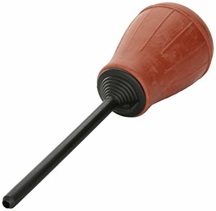

    Plain Jane Taco
    Plain Jane Taco Well-Known Member
    Apr 19, 2009
    #16179
    40,279
    USA
    I use a battery fluid filler. Works great
    eon_blue[QUOTED] likes this.
  15. Oct 30, 2019 at 1:12 PM
    #35
    TacomaMike37
    TacomaMike37 Well-Known Member
    Aug 12, 2013
    #110316
    5,085
    13' DCLB MGM
    Added to my Amazon cart!
  16. Oct 30, 2019 at 1:16 PM
    #36
    Plain Jane Taco
    Apr 19, 2009
    #16179
    40,279
    USA
    Sucks it quickly and it easily fits in the reservoir hole.
    Then I use a very small funnel to help fill it up.
    Just note the "cold" or "hot" marks. I always do it cold. That way it's a simple matter of filling up to the cold mark.
    Do this at every oil change and you'll always be good.

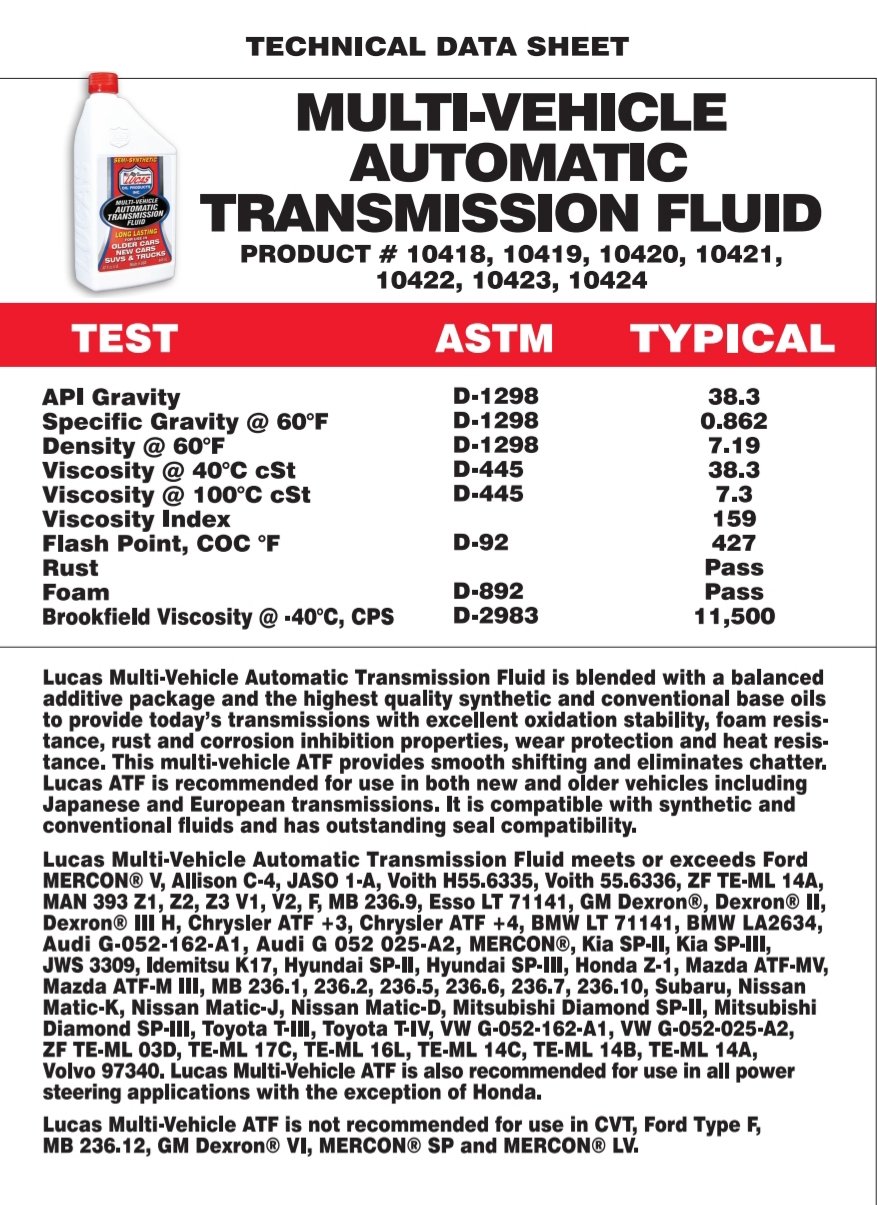

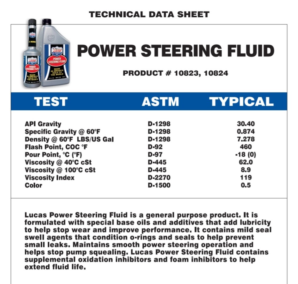

    Chris(NJ) Well-Known Member
    Jan 21, 2010
    #29777
    5,049
    Usually in Central Jersey
    08 Indigo 4x4 DC OR
    Mods are currently being changed .....
    I get more squeaking from the steering using Mobil1 ATF than when it had Lucas PS fluid in it. Next change I think I'm going to go back to Lucas so see if the squeaks disappear again.
