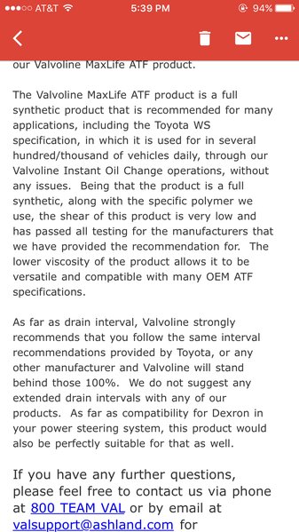

    You should be able to use Dexron VI, it is backwards compatible with previous versions of Dexron fluid. There is no longer a licensed version of Dexron 3 fluid, GM stoped licensing it when Dex 6 came out in 2006. Basically anything that says Dexron 3 compatible is just whatever the fluid manufacturer has decided to put in it. There isn't any spec that they have to conform to. I would check with Toyota before I used dex 6, but it should be fine.
  14. Mar 16, 2017 at 2:40 PM
    07 sport 4x4
    07 sport 4x4 Well-Known Member
    Dec 24, 2010
    #48165
    1,454
    Blake
    Southeast
    2017 Duramax
    I emailed Valvoline and asked them about it before I started using it. IMG_3986.jpg
