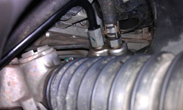

    The hose I took off to drain is the one with the spring hose clamp.[​IMG]
    Behind the left, front wheel.
