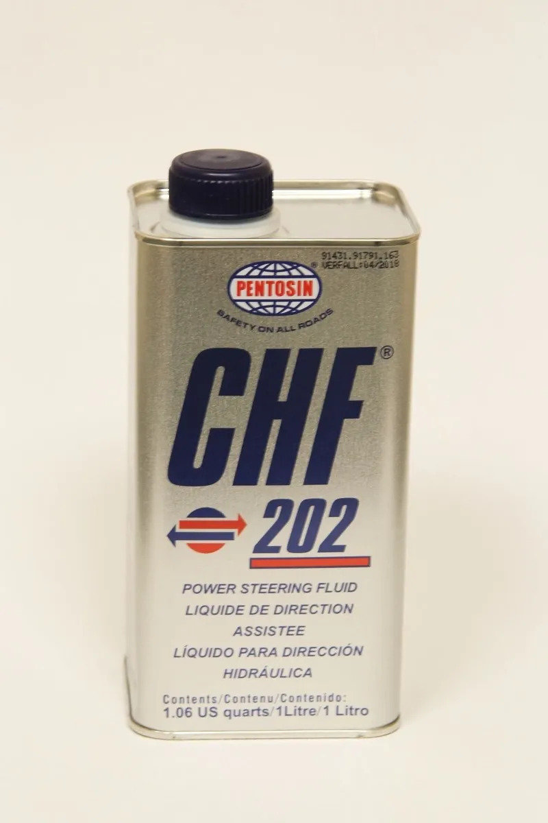

    joba27n
    joba27n YotaWerx Authorized tuner
    May 27, 2021
    #366948
    1,044
    Nolan
    Alberta
    2021 Gray TRD Sport Tacoma MT
    YotaWerx Stage 1, Bumper light bar, Hood wrap, Roadmaster Active Suspension, Durobumps.
    I personally used CHF 202 because I worked at Gm for 7 years and due to the cold weather bursting hoses all the previously speced systems that used Dextron were superceeded to this stuff... very pricey and not the recommended spec for our trucks but I figured with -40 here and another dextron system being compatible with it I felt confident using it. I'm 40k onto it with no issues but use at your own risk
  6. Sep 7, 2022 at 9:22 AM
    #26
    tonered
    tonered bartheloni
    Sep 25, 2017
    #231055
    31,063
    tony
    Lynnwood, WA
    That stuff was in our Saab back in the day. It was said to be very incompatible with other fluids. I'm not sure what the flush requirements are, but be careful.
    The owners manual for our Volvo was wrong and listed ATF from the previous gen when it actually used Pentosin. Had the stuff on my shelf, but needed to go and buy ATF . . . Well, a year later the rack fragged. I searched the interwebs and found another person that had the same problem. The error was in the OMs through the end of that model run.
