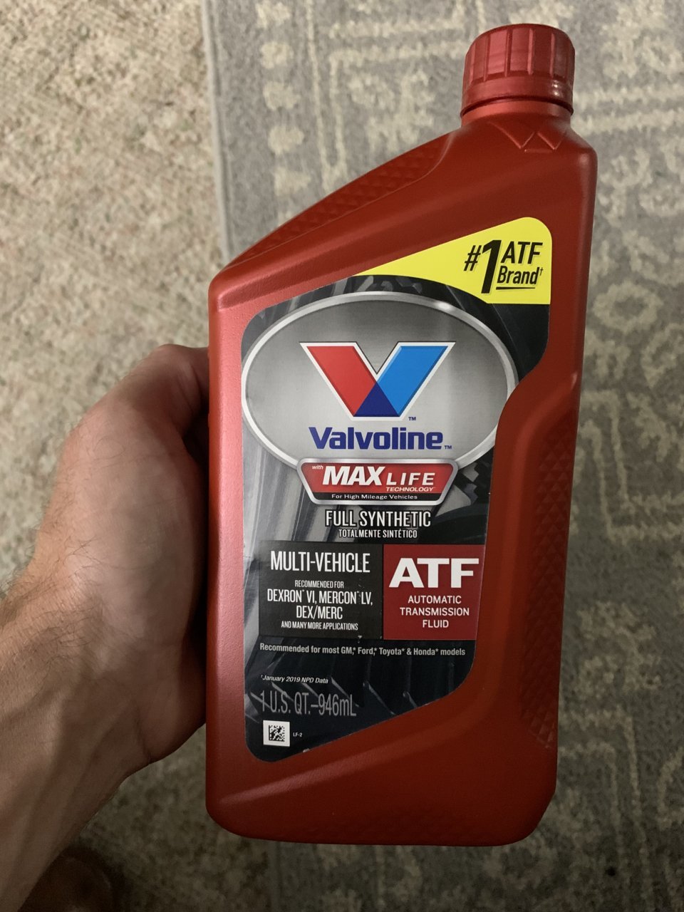

    Got 2 quarts of this today to do this weekend, hopefully. I wouldn’t use power steering fluid when it calls for ATF.

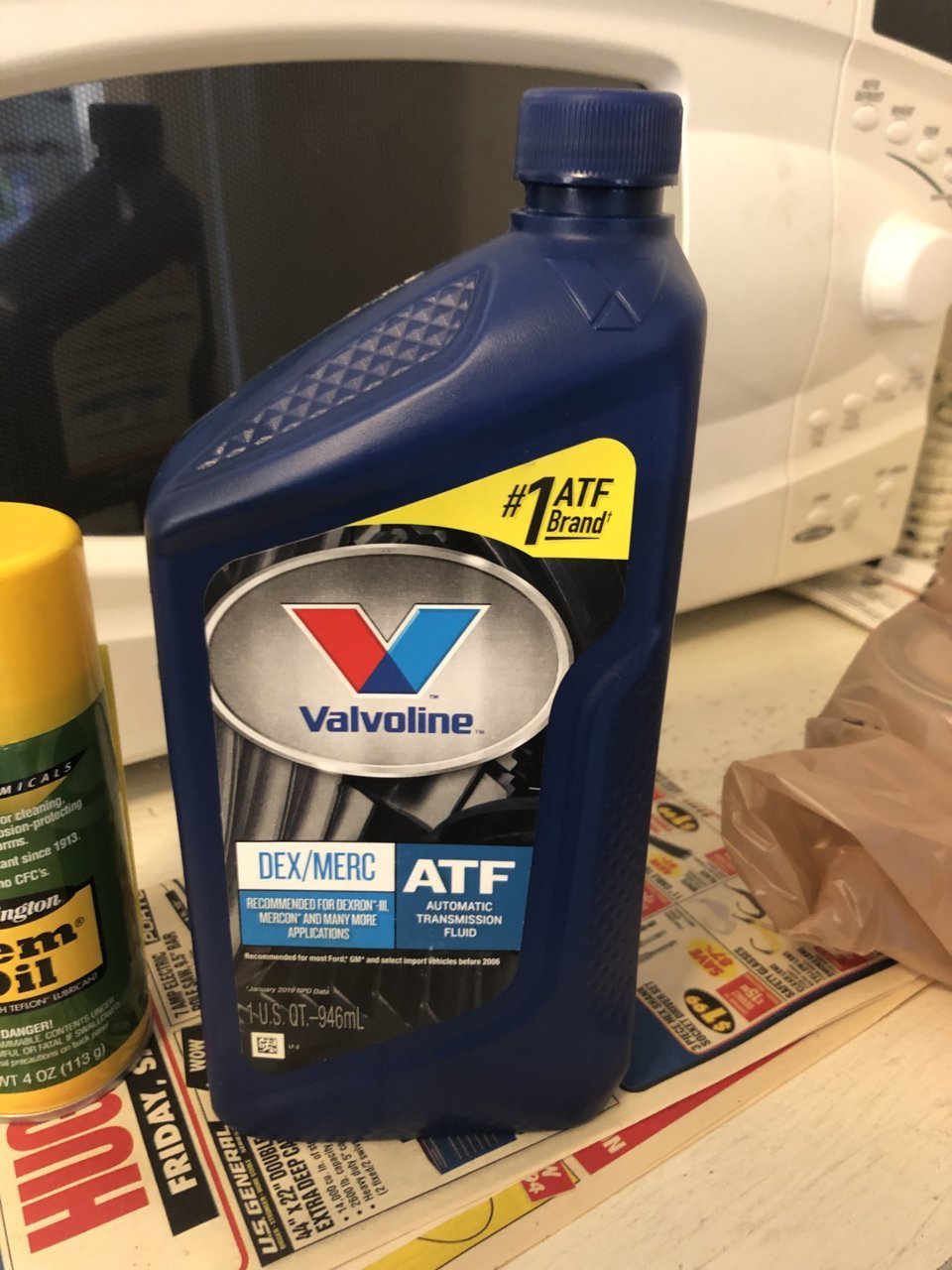

    I found the least expensive source for Dexron III was actually at my local Toyota dealers, which carry Mobil ATF D/M, compliant to the Dexron III standard.
    I would avoid the low-viscosity stuff like Valvoline Max-Life, Dexron 6, etc. to minimize the chance for leaks. The Taco steering rack is already notorious for leaking. No need to encourage it!

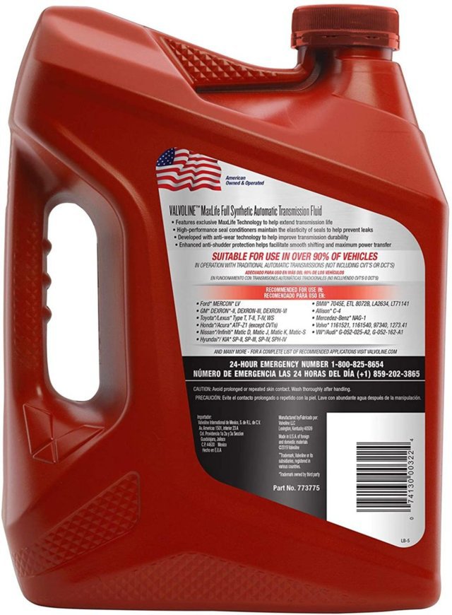

    Here is the back of the same but bigger bottle.

    I don't know about that. As far as I know it will leak if you leave it with dirty fluid. Never heard complaints about Maxlife and it is usually the most recommended by people here.

    I'm not advocating leaving it with dirty fluid. Max-Life is intended to be a replacement for Toyota WS, Dexron 6, etc., so it's thin, therefore more likely to leak. Less risky to use something closer to actual Dexon II or III, which is cheap and widely available.

    Even if it says in the back of the bottle that it is also a replacement for Dexron 2&3?
