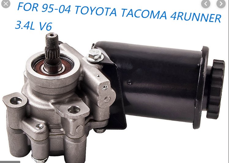

    im having a problem with the ATF just blowing itself all out of the resevoir...the ONLY thing I can find points to this screen
    anyone have this experience?

    Air in the system?

    Everything but the driveshaft. B03A - 410
    Since the old screen was disintegrating, I bought a new cheap pump for around $50.
    Shelved the pump and used the new reservoir and o-ring with the original OEM pump.

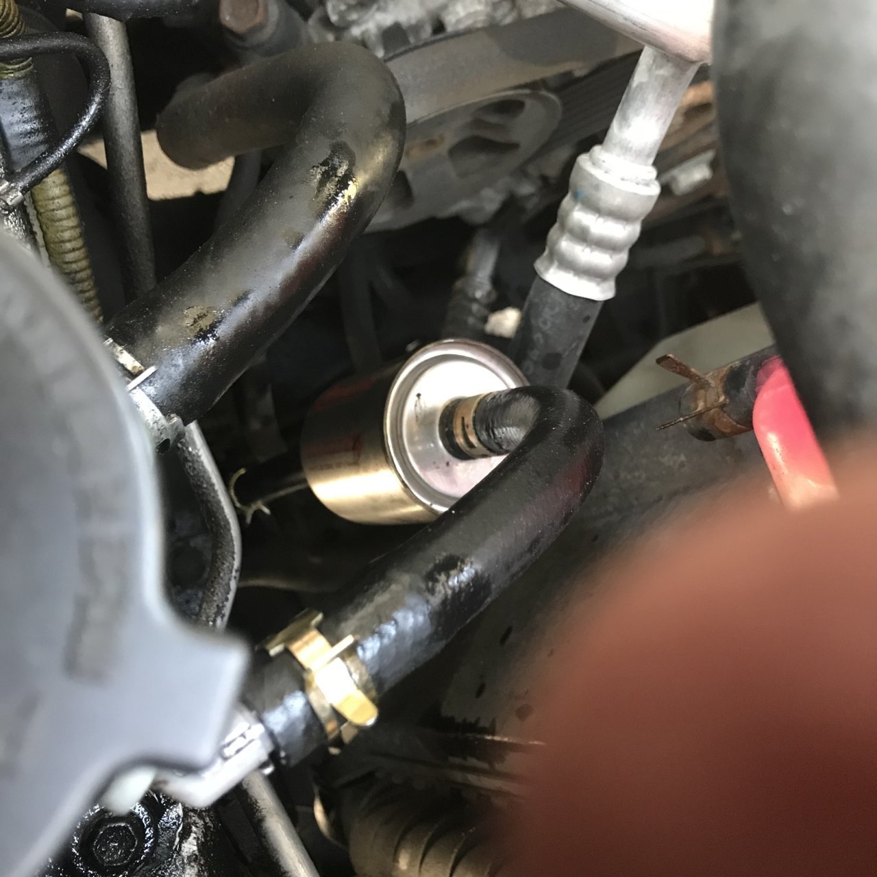

    I doubt they sell the mesh for the reservoir separately. You'd have to replace the whole reservoir. One choice is you try to grab one from a wrecking yard like PicknPull. Another option is you buy one from somebody. There's a guy, Josh Young, who parts out 3rd and 4th Gen 4runners in Washington. 3rd Gen 4runners have the same 3.4 liter engine so I bet he would have a reservoir he could sell you for a fair price. The other option is what you mentioned, installing an inline filter. If you go that route, put it in the return line before the reservoir. I recommend a magnetic style filter like this one: https://amzn.to/35p6heN I use them for my trans and power steering. They are rated to last of 30k miles.

    yeah ima go the magn filter route, just ordered one off amamzon, thx Tim

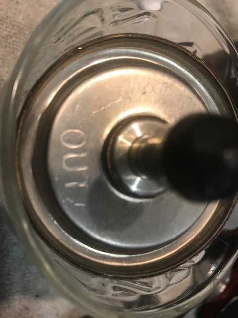

    which way does the arrow on the filter point to? the firewall/ground or the reservoir? sorry filter is on the mail and hust wana make sure, thx

    On the new designed magnefines (steel rather than nylon) one end is marked OUT. Hook the out end to reservoir line .If you have or or getting one of the older nylon ones the flow arrow will be in the direction of the line back to the reservoir. Dug up one the new filters i have and it looks like this. Its marked out only. This is the end that will feed reservoir. And I use the ones with the 3/8 inch connections and 3/8 inch ATF cooler hose (since this fluid is ATF and I had lots of it lying around)
