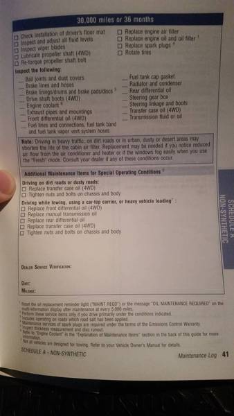

    I got Valvoline brand ps fluid at local auto parts store. I don't believe in Tranny fluid as the additives may not help/could hurt. Asked Toyota service tech and he showed me a generic PS bottle.

    you can also use a turkey baster and suck out as much as you can and replace yearly. easy to do and will keep fluid relatively fresh...it will mix just like doing a drain and refill in your transmission.

  4. Dec 22, 2014 at 11:45 AM
    #44
    Rockoma5
    Rockoma5 Well-Known Member
    Sep 19, 2014
    #138625
    805
    St Louis
    2019 TRD Sport Lifted
    shitty the spark plugs only go 30k. Anyone replace with Denso Iridium...those should be good for about 100k or so?
