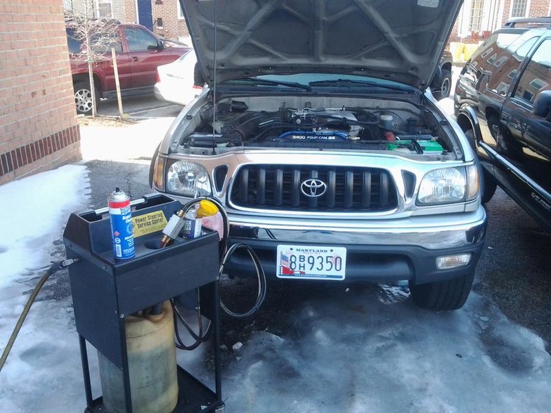

    I did a BG p. steering flush to mine after i replaced my pump because after installing the remanufactured pump i had a bit of whining. The flush took care of it.

    I did my BG flush with synthetic atf. In my pic above you can see a can of brake cleaner, that's what i used to clean the screen during the installation of my pump.
