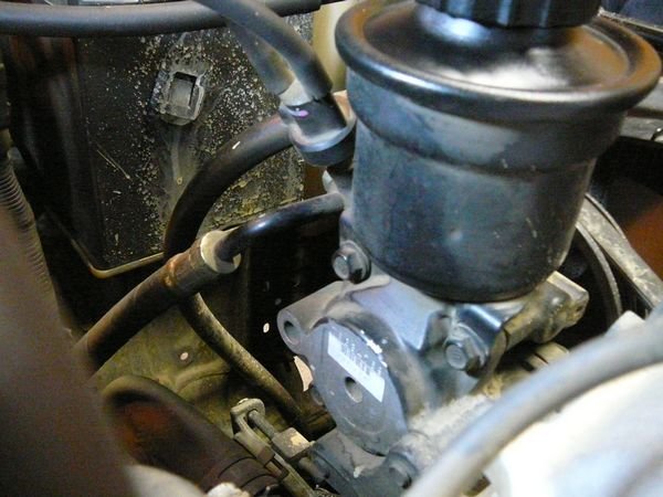

    Here is a photo, of those 2 bolts at the back of the pump of my truck. They are plainly visible just under the bottom of the reservoir. The third (and last bolt) is in front, behind a hole in the pulley (not in this photo).

    I have no idea how to access those bolts, at least all of them.... and my return hose, even after removing the little clamp didn't budge---- kind of made me felt pretty naive and helpless....and a pansy, can't even do this simple task

    I just realized you have the v6 (mine is the 4-cyl), so I'm assuming that access to the bolts is more difficult, and this is not such a simple task.
    You could call a shop (that knows Toyotas) and ask how much it would be to remove/clean the reservoir and screen. It might not be that much.
