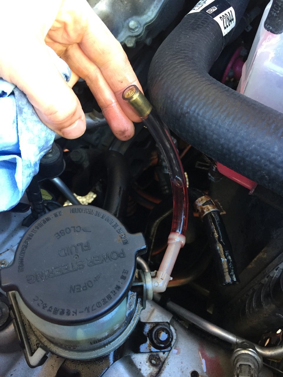

    Here’s a pic from when I flushed mine. As you turn the wheel, have a container (I used a soup can) the old fluid to drain into.

    what is the ID of that clear hose? thanks.

    I think it is 3/8” ID. Same as what I used for the transmission line when I flushed the trans. In metric I can tell you it’s 9mm based on the shell casing used to block it, lol

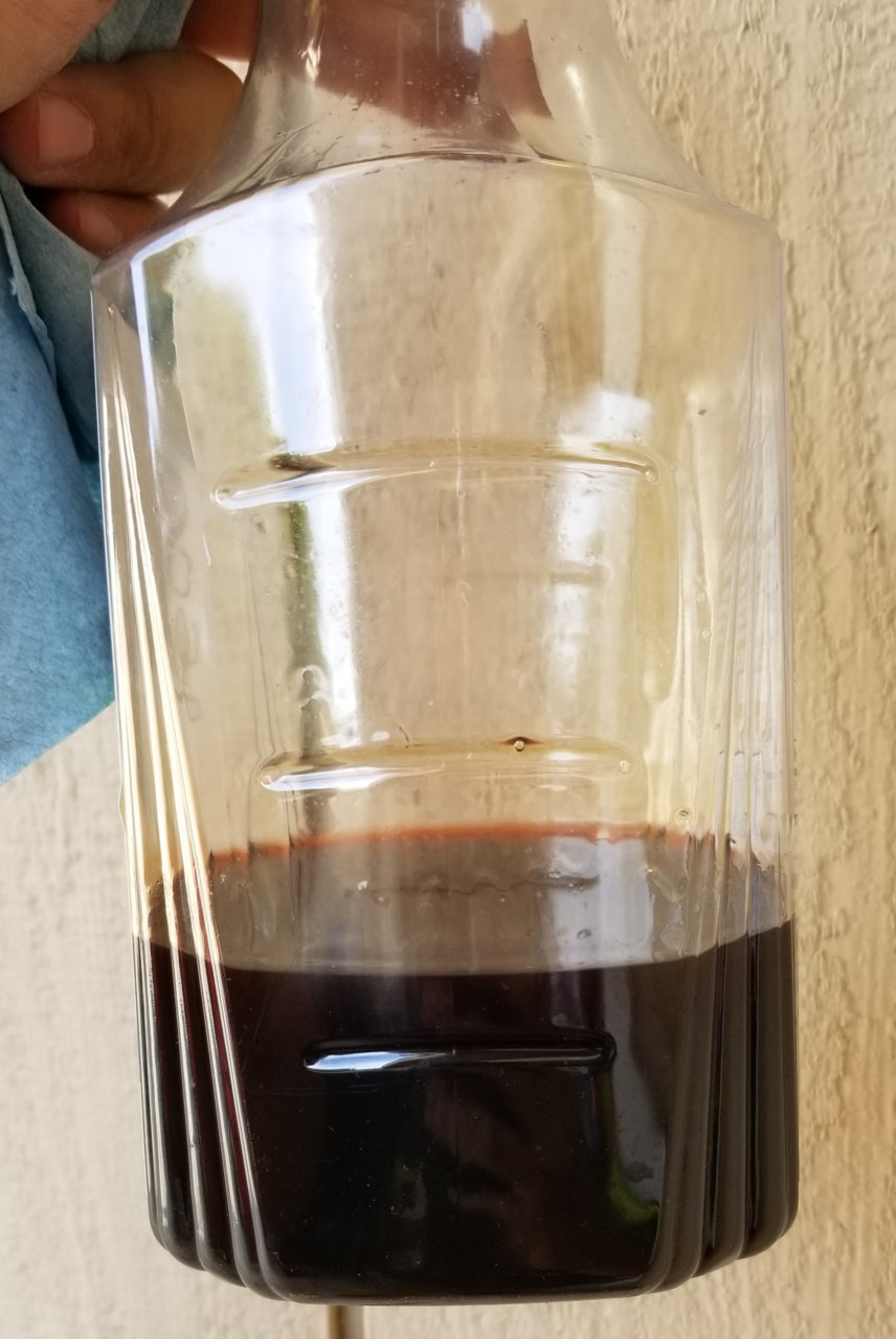

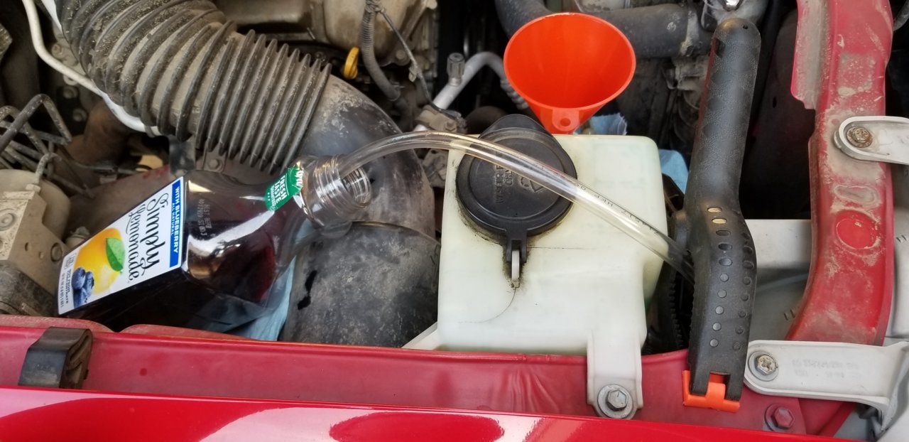

    Did my Power Steering flush today. It was easier than I expected, took me about the same amount of time as doing my oil change, going slow.
    Took some ideas from other posts I've seen. Siphoned out the old fluid, plugged the return barb(?) on the reservoir.
    I happened to have an extra length of hose, that could fit inside the return line. Then ran it to a place I could see, which happened to be on the passenger side. Viewing from the gap between the bottom of the windshield and open hood. I've seen some people using a male/male hose barb for this connection. But as far as I could tell, there isn't enough return pressure to need one of those. The factory hose clamp was enough to prevent any leaking.
    Then found a small funnel that fit inside the reservoir. Harbor Freight sells them in a multipiece set. Overfilled with Valvoline Max Life, and turned lock to lock once, then filled up some more. I estimate that you could turn full lock in both directions twice, before having to top off again. But I was extra careful, and topped off after each lock to lock. Lost track of how many times I did this, but it wasn't much.
    Some people have asked how much fluid you need, I found 1 quart to be more than enough. I used the entire bottle to make sure the flush was thorough. Fluid color turned red once 2/3 of the bottle for me.
    I also used a clamp to keep the extended hose from wandering off. If your careful enough, you can manage to lose less than a shot glass worth of fluid during the entire process. I've made a bigger mess doing an oil change.
    This was my old fluid.
