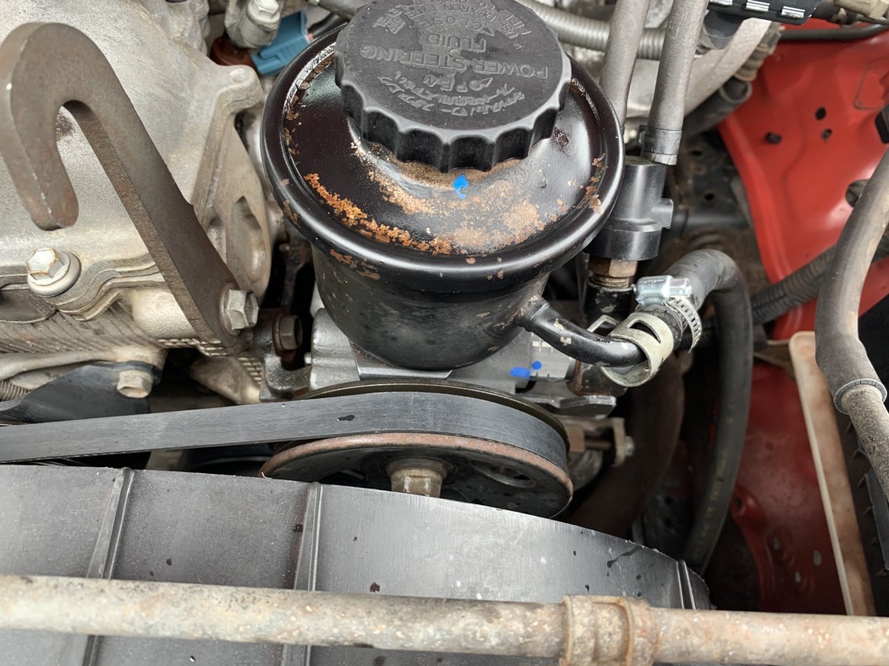

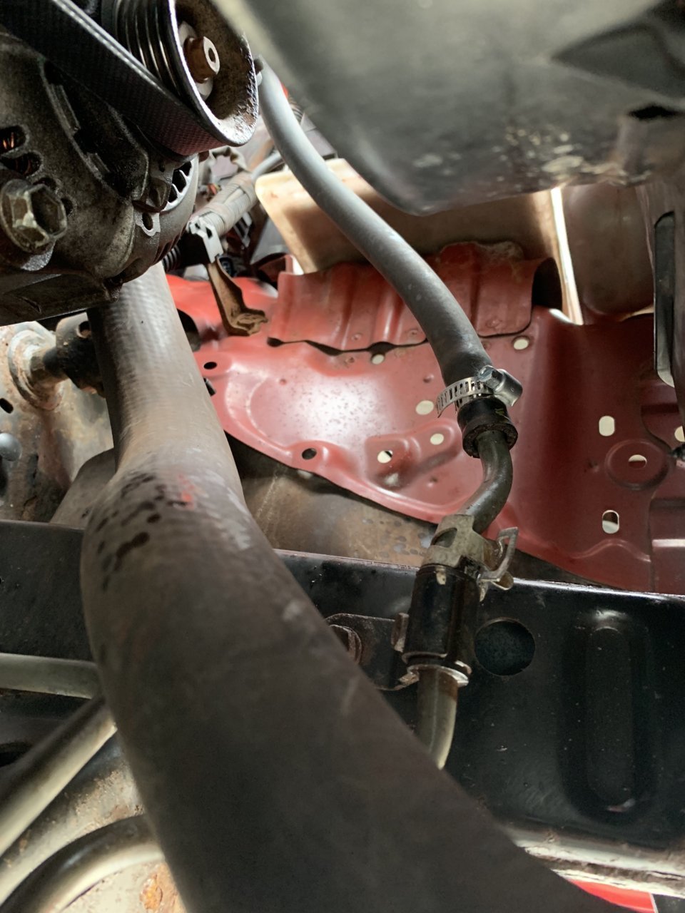

    Alrighty, short story
    Changed belts, fluid flush, bled the system.
    Removed reservoir - cleaned out with brake cleaner, more new fluid.
    Replaced power steering pump - all new fluid, bled the system.
    Every time I start the truck the power steering pump whines.
    Turn wheel to left lock and right lock a few times and now the whining stops for the duration of the drive. Turn it off and back on, whines again, repeats previous steps, fixed. Also bought new clamps for the return line so I know there isn't an air leak there. no leaking in the return line.
    Anyone have any idea whats going on? I feel like there's gotta be air getting in from somewhere every time I start it, because after "bleeding the system" after I start it, it runs fine.

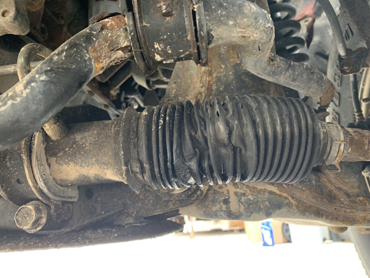

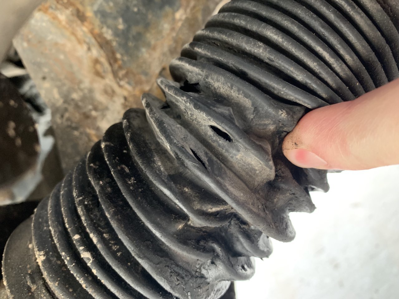

    I did notice I have to get a new steering rack boot for the right wheel because there is a tear. Maybe a chance that they seal inside the steering rack is damaged?
    Any help will be greatly appreciated. @Ritchie , any further ideas? Your comments were very helpful earlier when learning how to bleed the system.
    And since every story is better with pictures. (I did not cut off the original metal clamps on the return line yet because I'm still just trying to figure out what's going on).

    Don't think the boot is your problem.

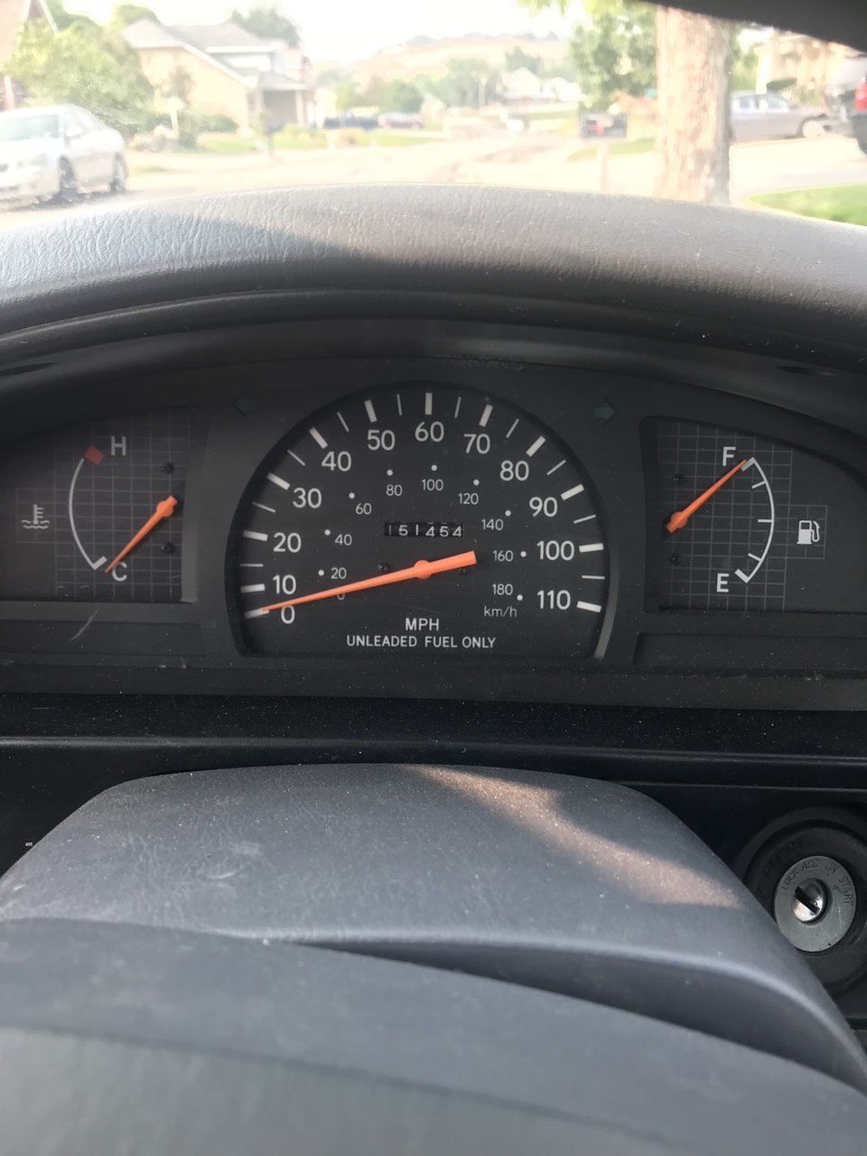

    What RPM does the motor run at when completely warmed up?

    Not sure... normal? Haha. My gauge cluster doesn’t have RPM. It doesn’t seem low though.

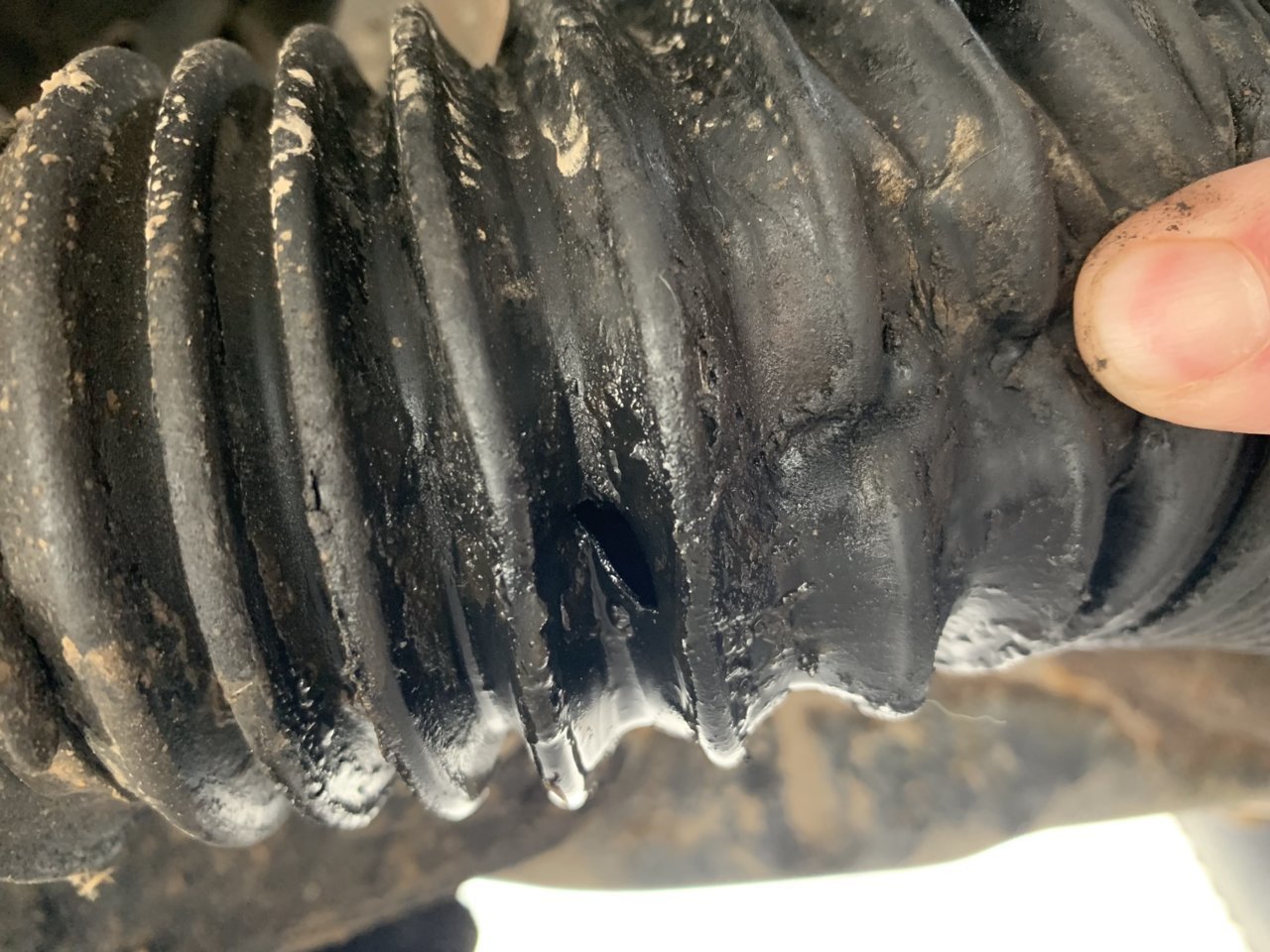

    The only place I can find anything wet is down in the steering rack near that rear in the right boot. My guess is I ruined the seal in there. It’s persistently wet around the hole and my guess is it’s just weeping. Maybe even right when I start the engine a little bit of air sneaks through that hole and finds its way into the system. Just grabbed a remanufactured rack and pinion set from a wholesale place down the road. Kinda my last chance to fix it haha. If this doesn’t work I’m just going to have to deal with it and keep an eye on my power steering fluid level
